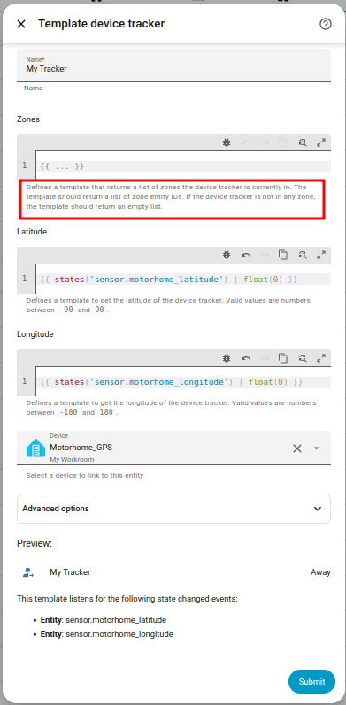

From what I can gather, given the above I need to create a "tracker" (using Settings | Devices & Services | Helpers | Templates | Device Tracker?) and use that Tracker in my MAP Card.
However, if this is the correct workflow, I can't figure the Device Tracker GUI?
In particular the Zones field. This is what I've got...
Sorry about the image - I can't find a yaml editor for this type of template.
Regards, Martin

That looks fine, the "Zones" field is optional, you can just leave it blank and click "Submit" to create the entity.
Doing that seems to be working on my instance...

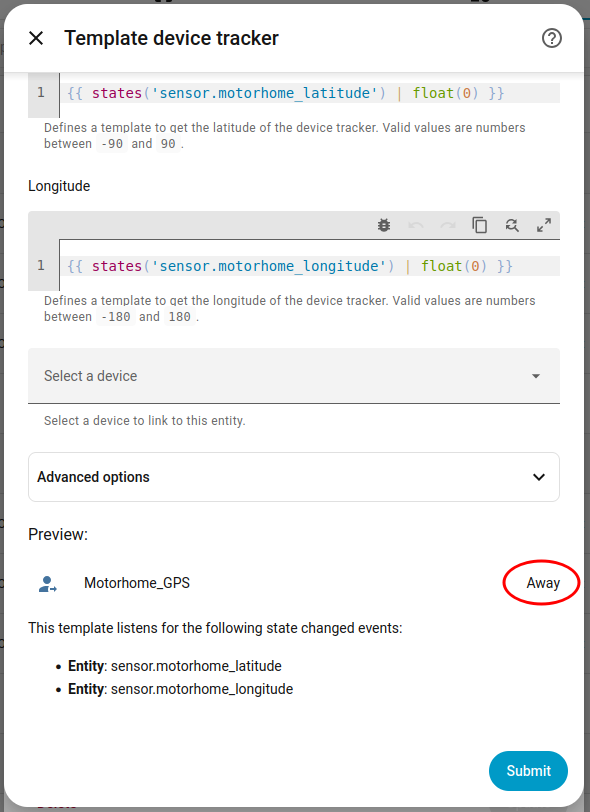

The setup preview of the device tracker shows that the "device" is "Away" and I am expecting "At_Home".

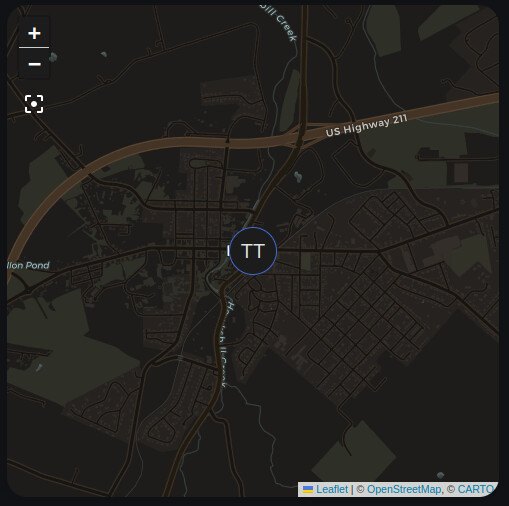

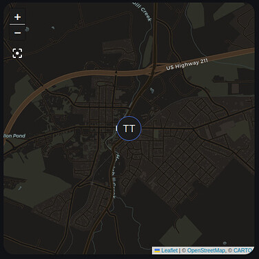

... and lastly the Map Card
type: map
entities:
  - device_tracker.motorhome_gps
theme_mode: auto
Displays my home zone but no target (tracker).

If the sensors' IDs are "sensor.gps_latitude" & "sensor.gps_longditude", why are you using "sensor.motorhome_latitude" & "sensor.motorhome_longitude" in the Template device tracker config flow?

I don't understand what you mean by that... the sensor entity IDs used in the Template device tracker config flow need to be the entity IDs of the sensors that actually provide the motor home's latitude and longitude.
How is the device that provides the motor home's coordinates communicating with HA?

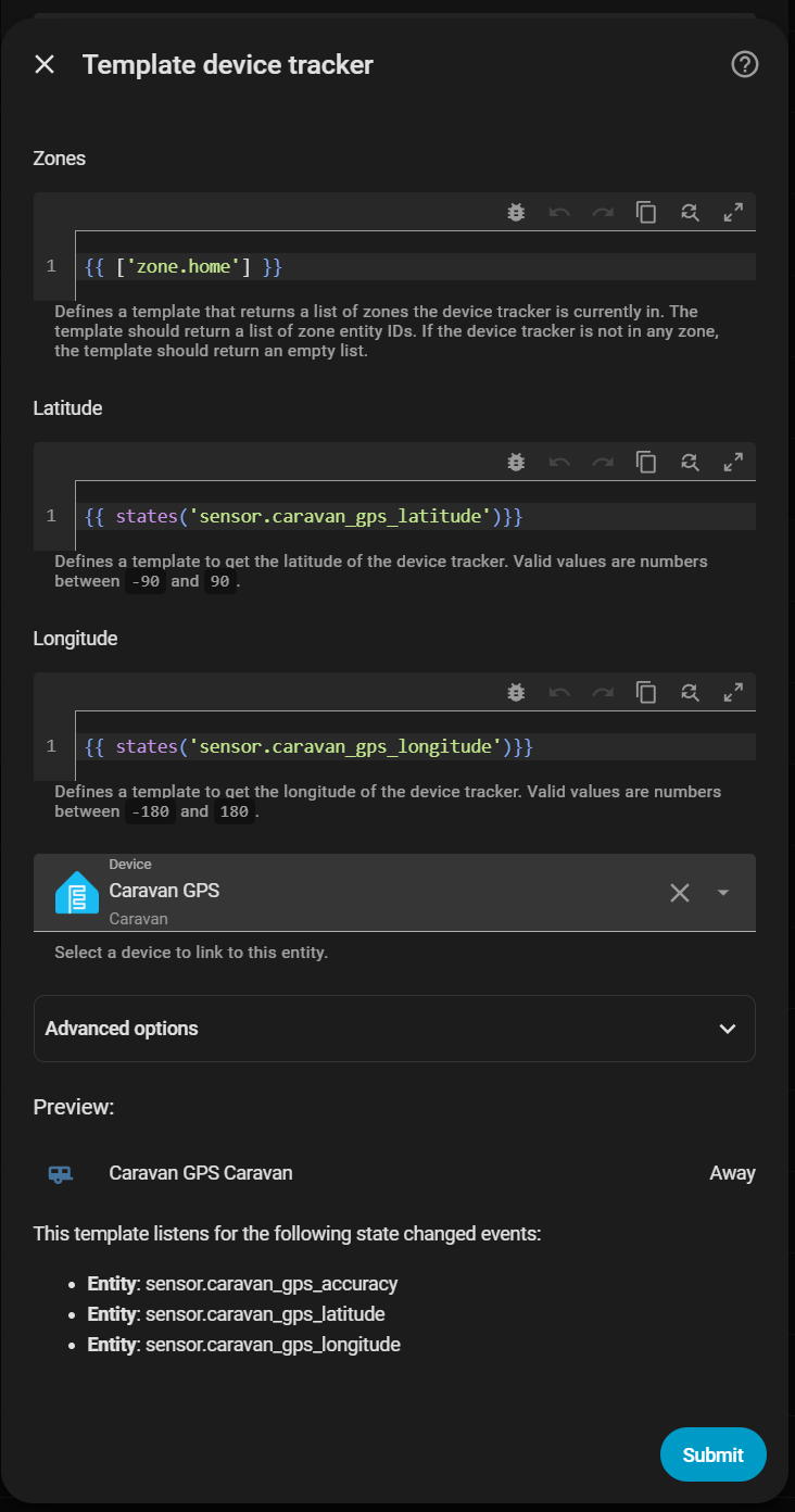

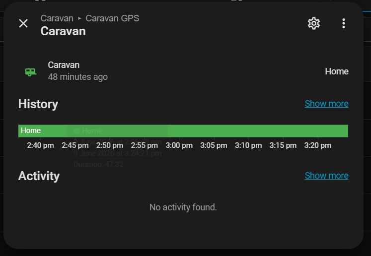

I have started using this and I think there may be a bug - in the template editor, the state is Away:
But the entity's state is Home ?
depends on what you filled out last. Your in_zones is a static template that never updates, meaning when lat/lon update, they will always provide the state. However when you first create the entity, in_zones will likely be honored because it gets all 3 templates at the same time. In that case, in_zones will be honored until lat/lon update.
I.e. You probably filled out that form top down, making lat and lon in the preview the "last updated template", and your lat/lon are probably outside your zone home radius.
It is in the home zone and if I remove the in_zones part it still shows away (only in the editor)

Is the actual entity state incorrect, or is it just incorrect in the preview shown in the Template Device Tracker config flow?
If it's the actual state, the possible issue I can see from what you have provided is the entity IDs you are using. Based on the ESPHome config you provided I would expect the entity IDs of the sensors to be sensor.motorhome_gps_latitude and sensor.motorhome_gps_longitude... double check that what you are using in the Template Device Tracker flow is correct.
