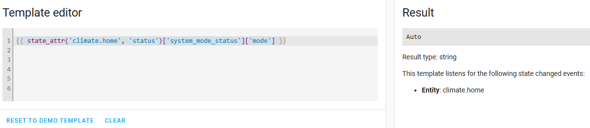

If I put this in Dev tools:
{{ state_attr(‘climate.home’, ‘status’)[‘system_mode_status’][‘mode’] }}
It correctly returns the state of the heating mode (Auto) in this case:
