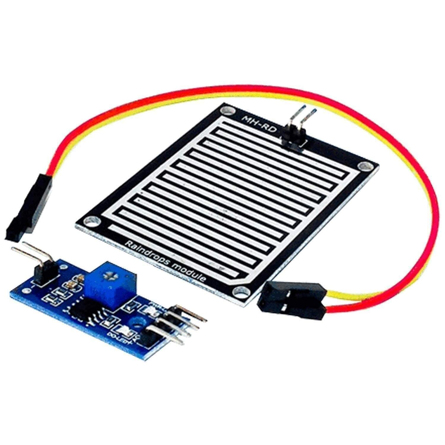

If you want to know if it rains immediately, and also when it stops, there are other solutions. The cheapest form is a panel with copper wiring on it. It is basically a contact sensor that relies on the conductivity of water. They react quickly on rain but take time to dry when rain stops, and have a tendency to corrode over time. They are cheap to replace though.

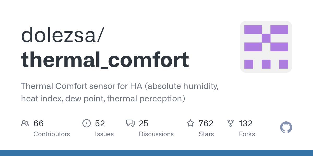

Another suggestion that may eliminate the temperature influence: The thermal comfort integration has, among many other things, a way to calculate absolute humidity from temperature and relative humidity. You should be able to see from this if the actual amount of moisture increases:
