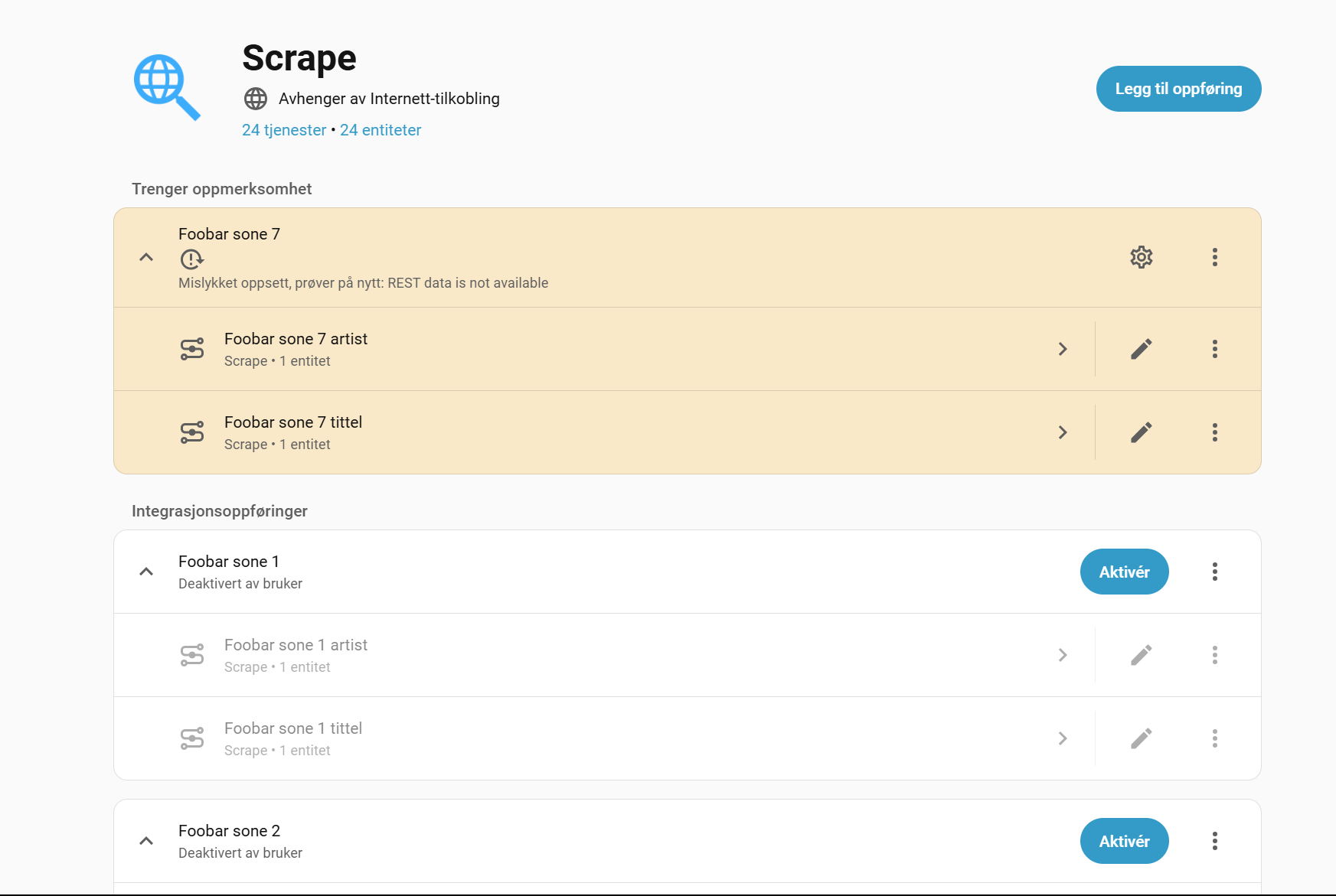

Here’s the integration, I have on purpose enabled one of the instances when Foobar isn’t running:
The problem with the naming is that I can’t find the naming convention for it. I have no idea what the ressources are named, which could for instance be scrape.foobar_sone_8 but isn’t, I only know what the ID for each of them is.
Ok. I’m UTC-8 so a bit slow first thing… But, I’m curious.
Foobar isn’t a typical integration where it has a page like the one you showed for Scrape. It’s just creating media entities. And it’s Scrape you want to disable, right, not Foobar? Scrap is the integration that is generating errors when one or more of your Foobar2000 instances are not running.
And what exactly is triggering the automation?
Right, you have to disable the Scrape config entry, not the associated entities.
In your image for Scrape it has multiple config entries, “Foobar some 7”, “Foobar some 1”, etc. correct? And when you click on the cog you can see each related config_entry id.
And each config_entry has two sensors that you are scraping. And the idea is when something happens to one of those you disable the associated Scrape entry?
When Scrape can’t, eh, scrape a web page does its entities change to “unavailable” or “unknown”?
Actually Foobar isn’t creating anything at all in Home Assistant. Foobar is running on a separate computer (with IP 192.168.1.4), creating the webpages with the playback info that Scrape reads. I can’t disable scrape itself, I have to disable all the ressources independantly, so when one zone starts playing that scrape ressource is activated, not all of them. The activation/deactication is triggered by an MQTT message that is sent by the Windows program on the server that starts and stops the Foobar instances.
When Scrape can’t scrape, the entities change to unavailable, but the ressource still keeps polling and polling and polling. So the way I’m doing it is the only possible way, as far as I can see.
