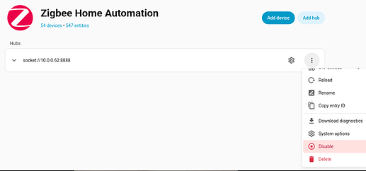

I’m using the Sky Connect for ZHA, how do I disable the integration without disabling the Sky Connect, presumably doing so would prevent HAOS from talking to the device?
Is there anything I should avoid doing or changing in case I brick it?
Go to ZHA’s integration page click on the breadcrumbs menu for your hub, then scroll down and click “Disable”:
