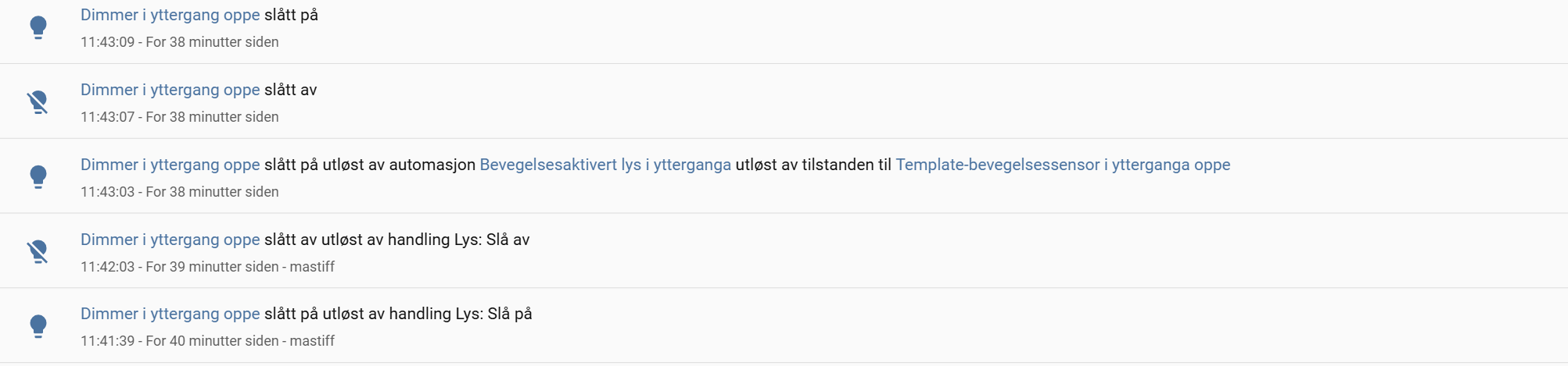

I need to run an automation when a light is turned on or off with the physical button. I see a possibility in the Activity log, I think. Because when I use Hass to turn on and off the light, it says “turned off by action light: turn off”. When the motion sensor light automation is used, it says “turned off triggered by automation motion sensor light”. But when I use the physical dimmer button it just says “turned off”. The same goes for turning on. it’s in Norwegian, but I think it should be understandable. “slått på” means turned on, “slått av” means turned off, and “utløst av” means triggered by:
So if it was possible to filter so only the one saying “turned off” and nothing else came through a condition, I believe it would work. But I’m not getting anywhere. I thought this could work, but it doesn’t:
