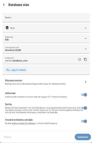

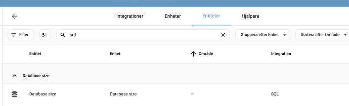

I can see the sensor entity like this:

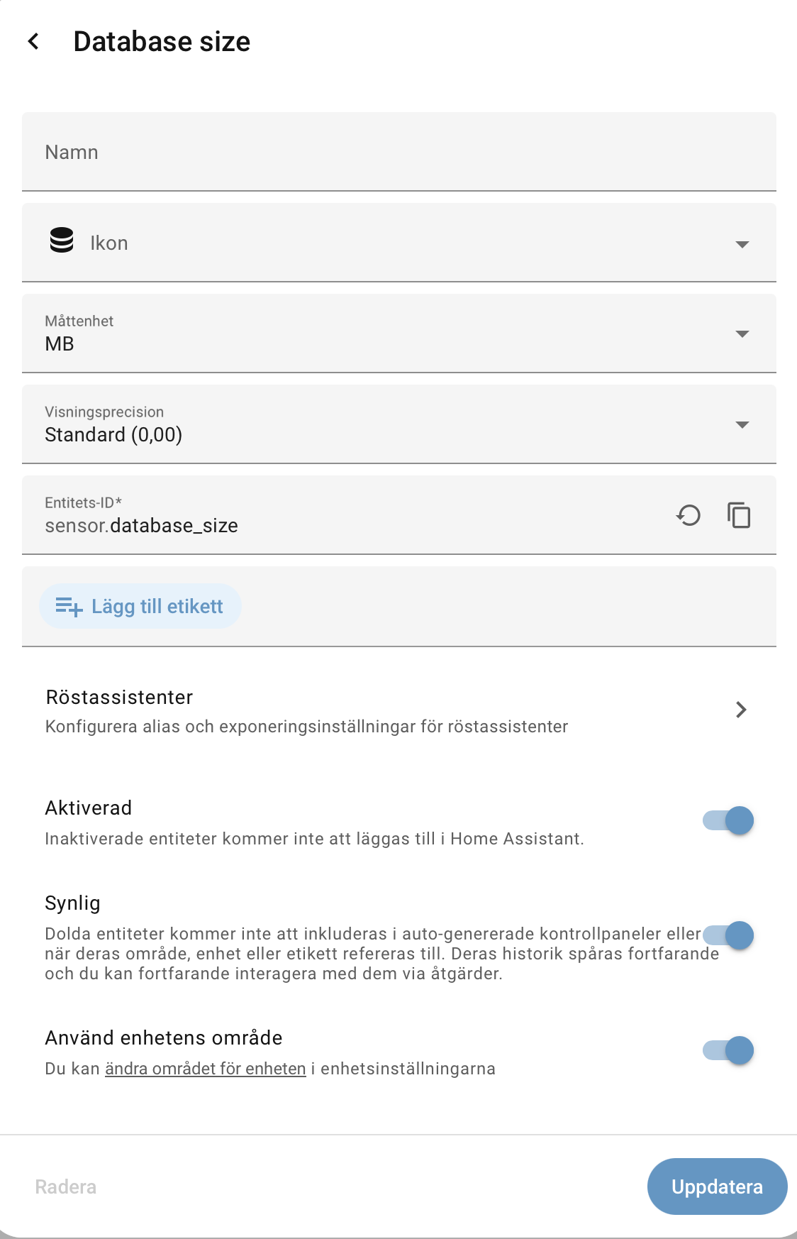

If I click on it I have no Delete button:

You could “un-click” activerad/synlig and update, i know it’s “Not What You want”, but until you find which doc this sensor(request) comes from, it’s might be a “remedy”
You have the SQL integration installed.
If that’s the only entity it has & you no longer need the integration, then disable/delete it.
Here be dragons. Make sure you have reliable, off device backups of your database before you start.
It’s a core integration which simply provides sensors. Deleting it won’t affect their db in any way.

This was the solution. Thanks for pointing me in the right direction!
I removed the SQL integration, the warning is gone and HA works as it should.
