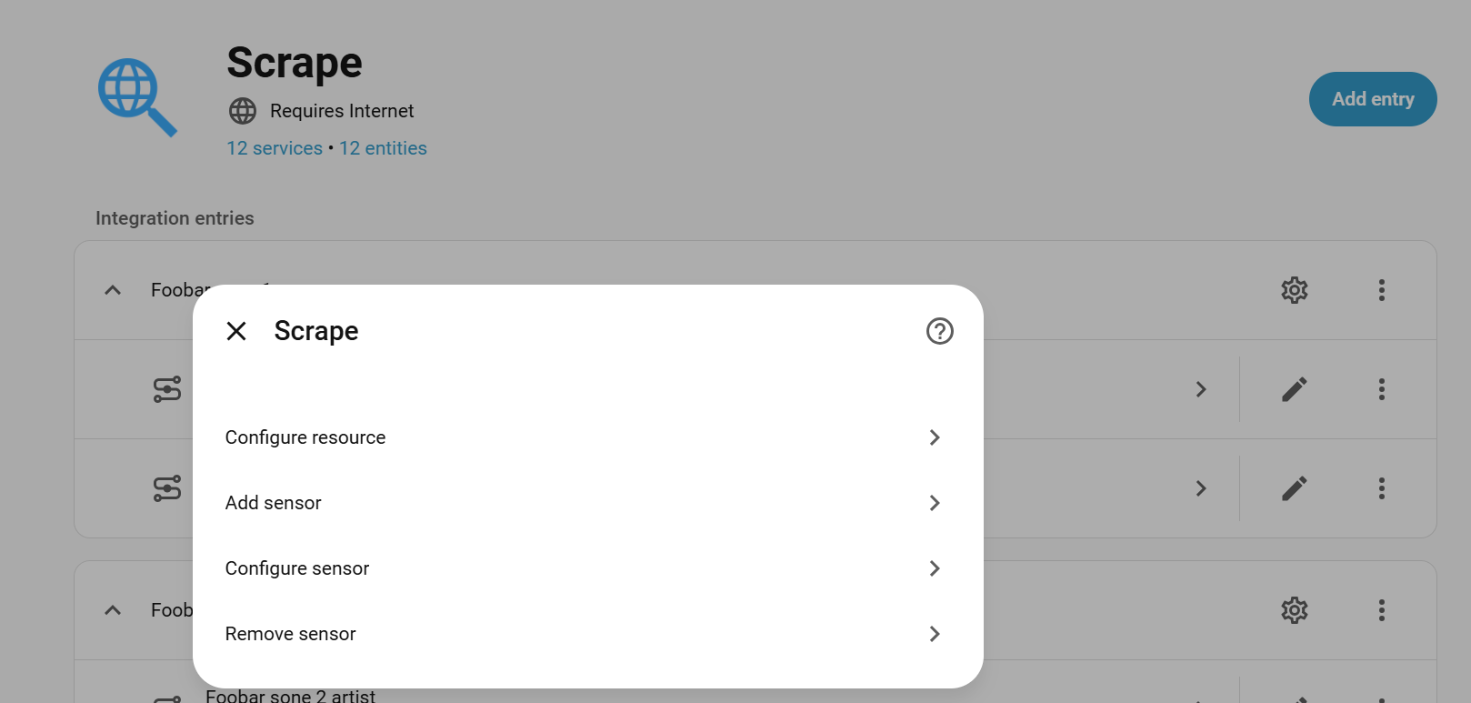

  2. I should have written entry, not sensor where the resource is mentioned, so that’s on me. But there is only one “Resource” per entry in the Scrape integration that can be configured, see screenshot (as I wrote, all the excisting entries are identical):

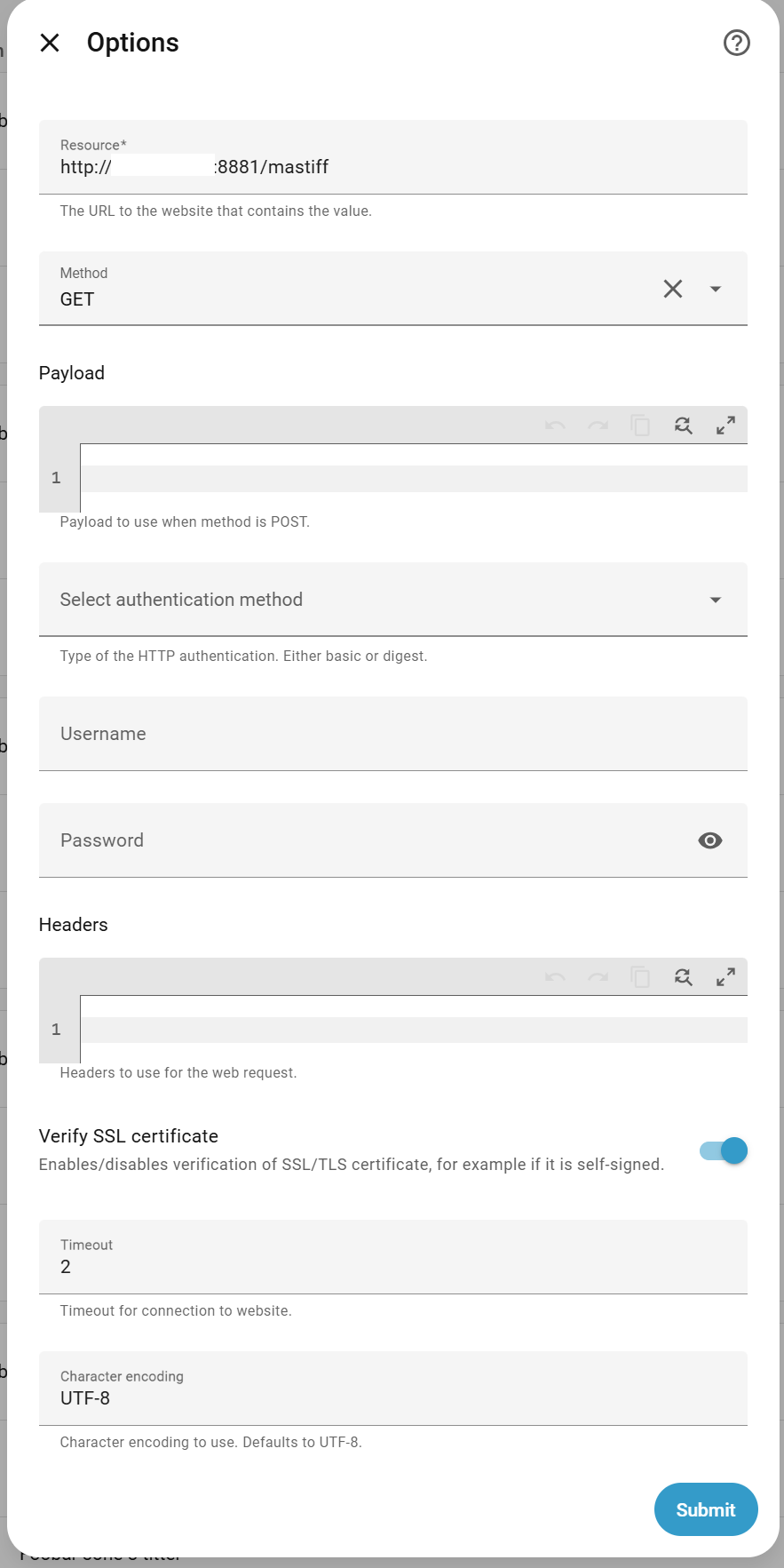

When clicking on that menu, I get this box:

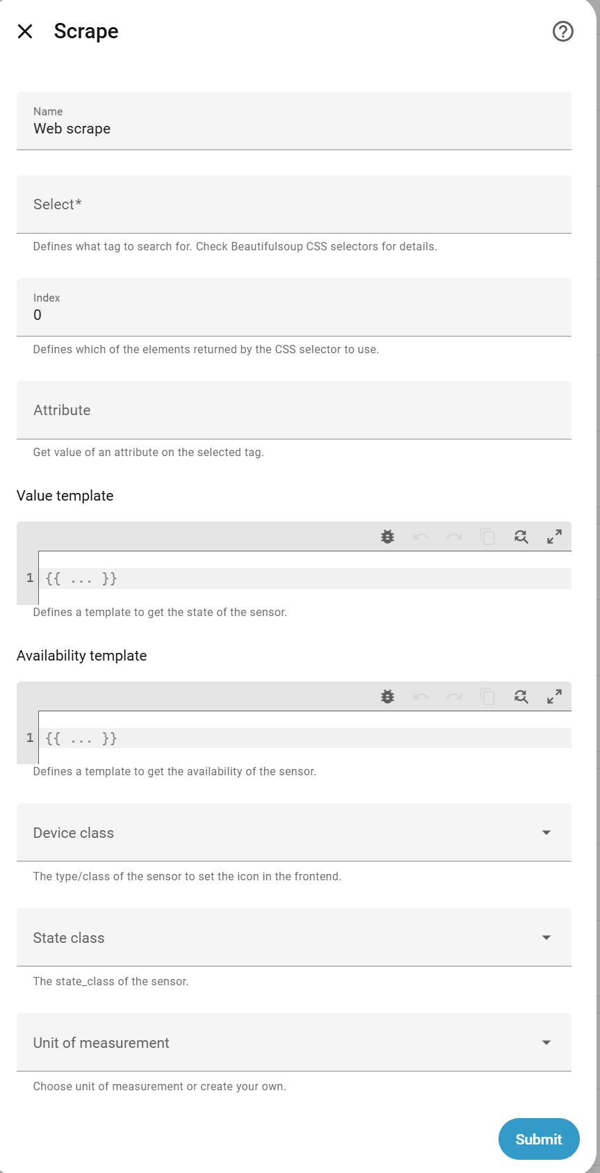

The problem is that this is only half of the configuration. When configuring a new entry, I first have the same box, and when clicking “Submit” on that box, I get a second box, this:
The second field in that box is:
“Select Defines what tag to search for. Check Beautifulsoup CSS selectors for details.”
And nothing from that second box is shown when I open an excisting resource to configure it, so maybe three or four years after I created the other ones I have no idea what to put in that field for it to work as the existing ones do. That’s my problem.

I put this on a backburner and picked it up again today. It turns out that the "tag" is not in the ressource, which I thought because it seemed to be a part of the setup of the ressource, it's a part of the actual sensor. So artist and title was the tags I needed. My bad, I just didn't connect the dots.
