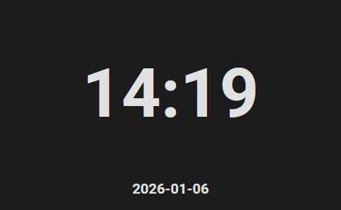

With this code:
<center>
<font size=7>
<h1> {{ states('sensor.time') }}
<br>
<h2> {{ states('sensor.date') }}
I get this:
Thanks

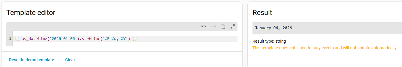

Use strftime. Example in Developer tools | Template
{{ as_datetime('2026-01-06').strftime('%B %d, %Y') }}
Output is:
The different codes are at
Python strftime reference cheatsheet
However, if you want it in Italian, you need to provide all translations yourself.

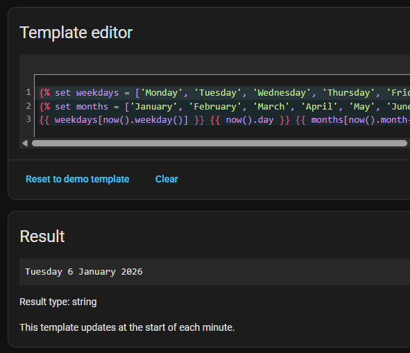

Example in English
{% set weekdays = ['Monday', 'Tuesday', 'Wednesday', 'Thursday', 'Friday', 'Saturday', 'Sunday'] %}
{% set months = ['January', 'February', 'March', 'April', 'May', 'June', 'July', 'August', 'September', 'October', 'November', 'December'] %}
{{ weekdays[now().weekday()] }} {{ now().day }} {{ months[now().month-1] }} {{ now().year }}
