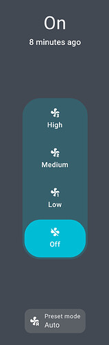

This is what I see when I go to Settings → Devices & Entities → my air purifier entity. I want this on my main dashboard, but I can’t figure out how.

How do I get the selector from my screenshot to my dashboard? It’s already pretty much exactly what I want, I just need it in another place.
Check out the Features available with Tile card.
Great, thanks. The tile card did it. Now I just need to find a way to reliably get the fan speed, but that’s probably another thread in future.
