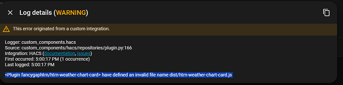

log shows this. i have no idea how to fix it.
image286×169 3.89 KB
move line 12, 2 dashes to the right ... same goes for line 13
still throws a bad indentation of a mapping entity error
if i do this it doesn't throw an error. not sure if it'll get rid of my "Lovelace is running in storage mode. Define resources via user interface" warning though. will update once i restart hass
it's telling me to use Settings > Dashboards > Resources. didn't know that existed until now
I got it working! it turns out what i needed to do was change "/hacsfiles/htrn-weather-chart-card/htrn-weather-chart-card.js" to "/hacsfiles/htrn-weather-chart-card/dist/htrn-weather-chart-card.js" in the resources UI.
