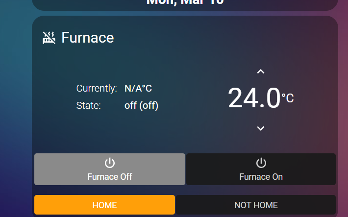

the climate sensor doesnt get update only when its forced it sits there if the sensor is unavalaible the Temperature stays the state like i said
here its set to null
Did I mention the climate entity?
its not an entity its an attritubte… you see if you set it to NULL to goes to N/A
