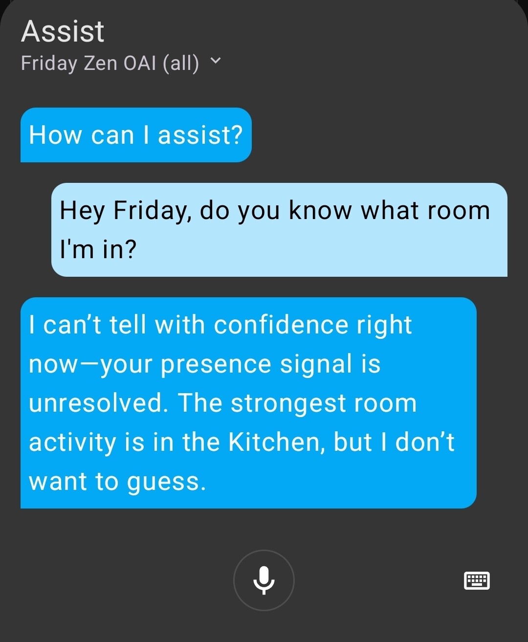

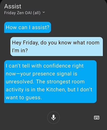

This is the basis of how my Room Manager works in ZenOS for my LLM agents.
It works out like this…
(also she’s right btw. That translated to AI assistant for:‘I read your sensor and it’s reporting a low confidence kitchen score because your phone hasn’t settled ina room but holy moly the kitchen is lit up like a Christmas tree…’)
