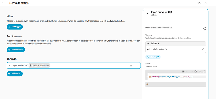

You can use templating in the value (target value) field
You probably want something like
{{ states('sensor.my_battery_charge') | float(0) }}
although you will have to decide exactly what your sensor holds in the state value. This will be a string, and you need to turn it into a number, either integer or float, depending on how you set up your input_number helper (step size as integer or float).
You can test any template in the Developer Tools > Templates to make sure it returns the value you want, or use the ‘debug’ icon in the value edit window to turn on testing.

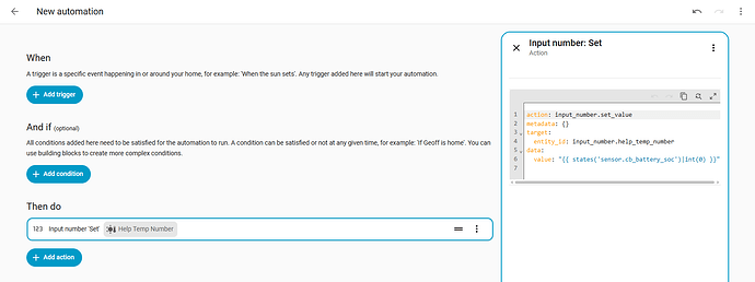

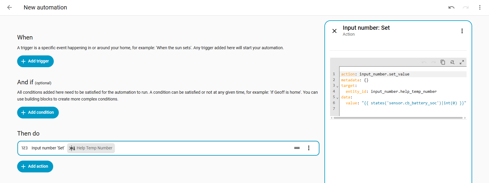

We need to set a template for the value, but the UI does not permit this, so switch the action to “edit in YAML”, which will give you something like the following with the correct action and your target entity:
action: input_number.set_value
metadata: {}
  entity_id: input_number.help_temp_number
data: {}
Now we edit the data: {} bit to provide the value template we want
Replace data: {} with
  value: "{{states('sensor.solaredge_i1_b1_state_of_energy') | int(0)}}"
This sets the action data object with a property “value” which has a string containing a template. This should render correctly.
Note that you need the quotes around the template.
You can return to the UI editor mode, and the value box should now show the template, and allow you to edit the template, and also should work with the ‘bug’ option to render the template in situ.
