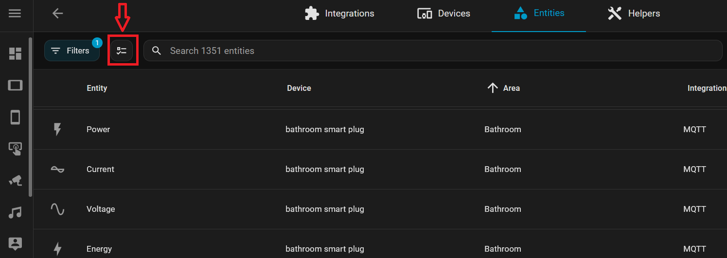

You could check if there are still some entities from that device:
Open your Home Assistant instance and show your entities.

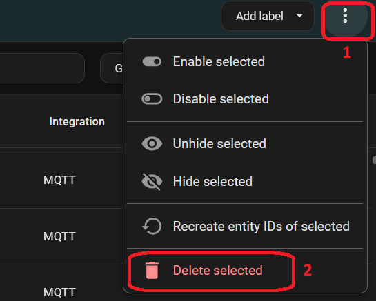

Make sure the selection boxes are visible in case you want to delete multiple entities:
Delete unused entities:
Check if you can delete the device.

I have marked the subject answered - it was having the selection boxes hidden that was blocking the delete, all done now apart from one that refuses - it was an old MQTT one that has no entities now.
