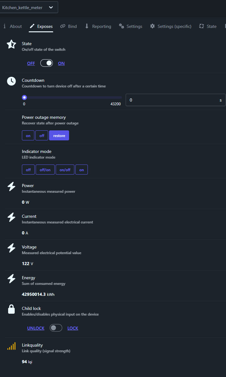

How do I reset Tuya TS011F_plug_3 total kwh value?

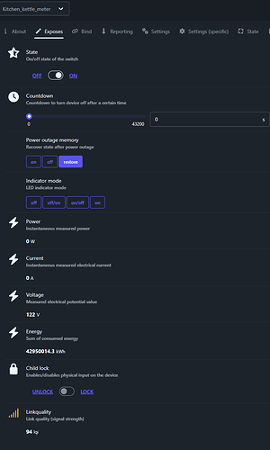

So… the Tuya TS011F_plug_3 shows total used energy as… 42 gigawatt/h see the screenshot below.
I am not pretending that I have Thermonuclear Ignition Facility at my backyard, yet, the above situation. How do I fix it?

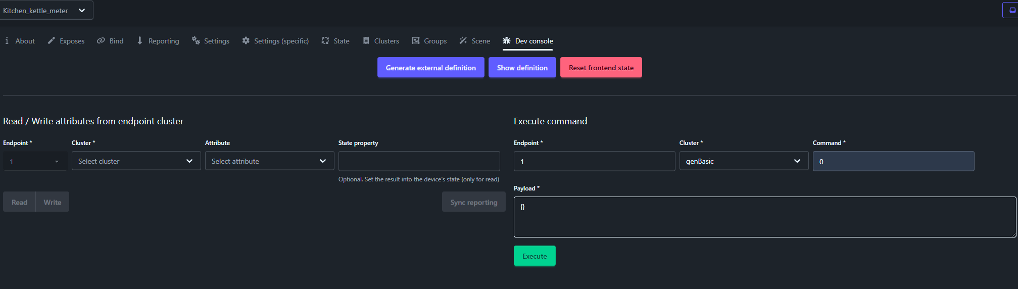

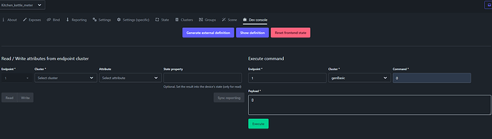

I tried to execute reset via Z2M dev console of this device but got zero response
[1/8/2026, 5:45:59 PM] frontend:api: Sending {"topic":"0x70b3d52b6000f48e/1/set","payload":{"command":{"cluster":"genBasic","command":0,"payload":{}}}}
