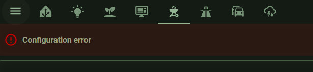

Background: I’m trying to add a custom:plotly-graph for the first time. I’ve reloaded yaml and have a very simple initial config that Lovelace is complaining about:
        - type: custom:plotly-graph
          entities:
            - entity: sensor.ibbq_6_temperature_probe_4
              hours_to_show: 4h
              refresh_interval: auto
I am not using this card but probably it should be
entities:
  - entity: sensor.xxx
hours_to_show: 4h
i.e. the “hours_to_show” is a global (not per entity) option.
Unfortunately that doesn’t work. I tried with and without hour_to_show at the correct indention. So… my Lovelace “configuration error” remains… :confused:
Post a screenshot with UI editor with your code and the error.
I’m using yaml mode, but your post prompted me to try it in GUI mode - which said the card wasn’t loaded. I fixed that, and now it works - so thanks.
If only the error message had said that to begin with!
