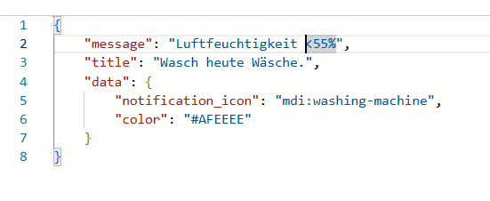

I tried using the updated HA nodes but then I noticed that the special characters “%” and “<” don’t show in HA companion app notifications, even though they did before, I think. Any idea what to do about this?
    "message": "Luftfeuchtigkeit <55%",
    "title": "Wasch heute Wäsche.",
    "data": {
        "notification_icon": "mdi:washing-machine",
        "color": "#AFEEEE"
Leave a space after the <.
"Luftfeuchtigkeit < 55%"

You can use the alt code for < "Luftfeuchtigkeit &#x003C;55%"

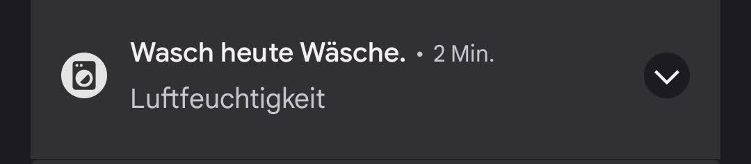

Can you screenshot what is happening? In the node red addon logs are there any errors or warnings?
How I originally did it:
How the Notification this produces looks on my Android phone:
As you can see, the number as well as the %-sign aren’t even displayed here.
Node Red doesn’t show anything in the log upon me triggering this notification.
Using the alt code for “<” solved the problem.
