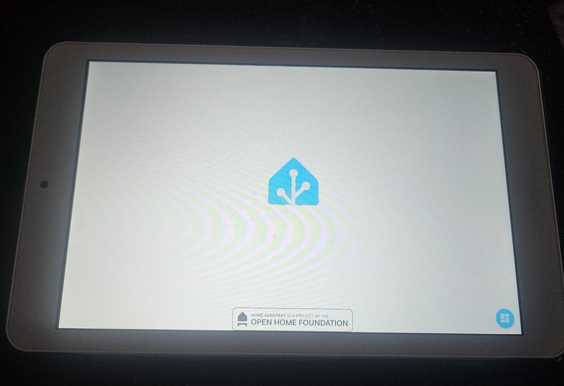

I’ve already tried that, but it gets stuck (see picture). I’ve also tried different kiosk apps, but I always end up stuck at this point and can’t log in.
I really have no idea why this is happening.

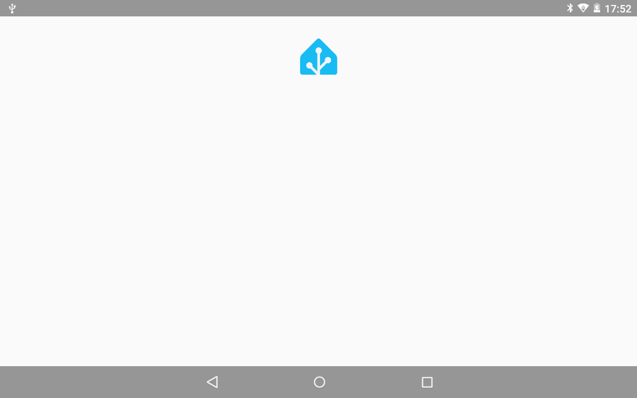

I still encounter the same problem with other versions. (See picture, this is what happens after submitting the Home Assistant server URL.)
Is anyone else experiencing this issue, or does anyone know a solution?
