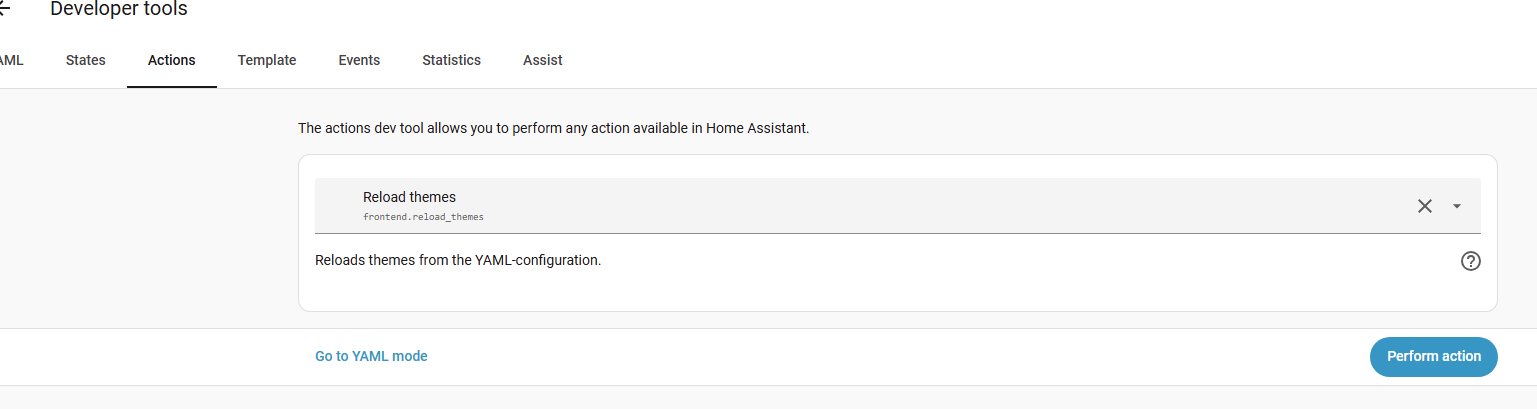

P.S. Do not forget to select your theme in a user profile page, do not forget to call “reload themes” services in Dev tools->Actions after editing a theme.

Not needed.
Check my comment above, this is wrong.
Must work.
For testing - create this new theme & try it:
test:
  state-switch-on-color: green
  state-switch-off-color: red
  state-unavailable-color: blue
and do not forget to reload themes as I wrote above.
ok its working now the quick reload didnt work when i did do a full reboot
then it worked… didnt need to clear the cache… guess something was stuck that it didnt like…

Did you reload themes in Dev tools - Actions?
no i was doing
Developer Page —> Restart (Check and restart) page didnt know there was a restart under actions

No need to restart a SERVER if you need to reload frontend themes.
Easier to just reload themes, takes less than 1 second (and restarting a server may take a few minutes).
