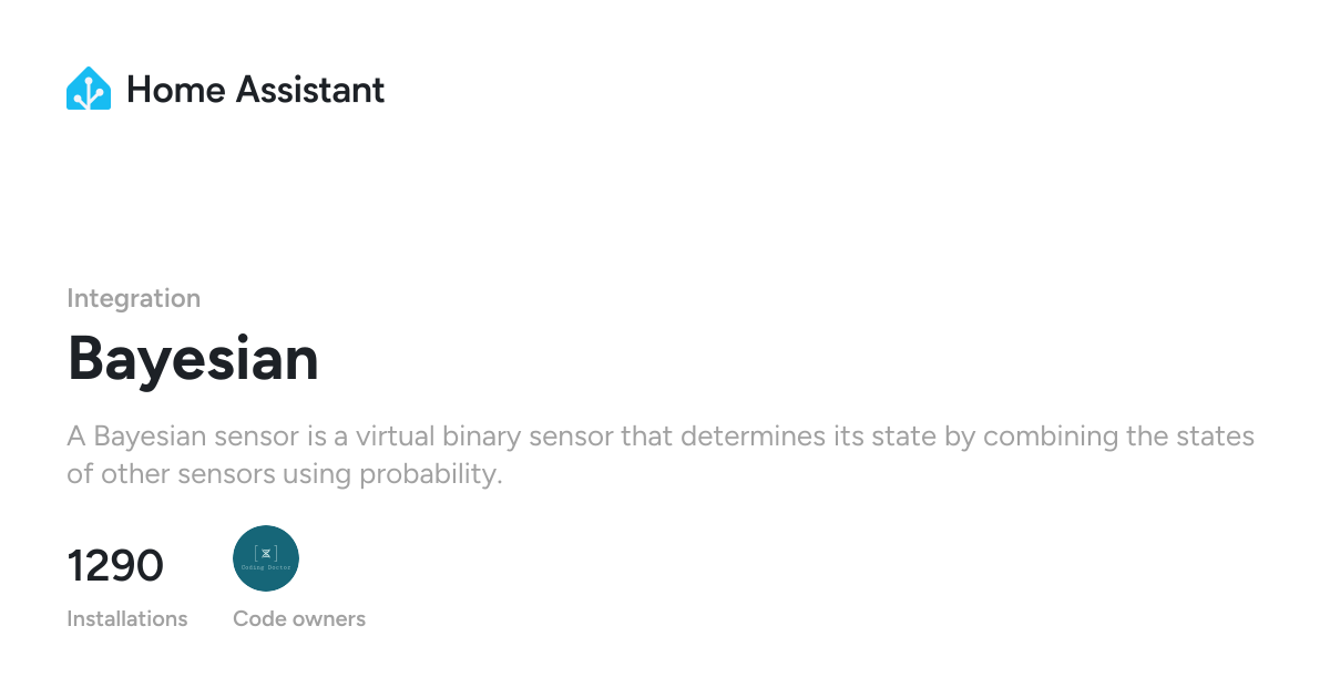

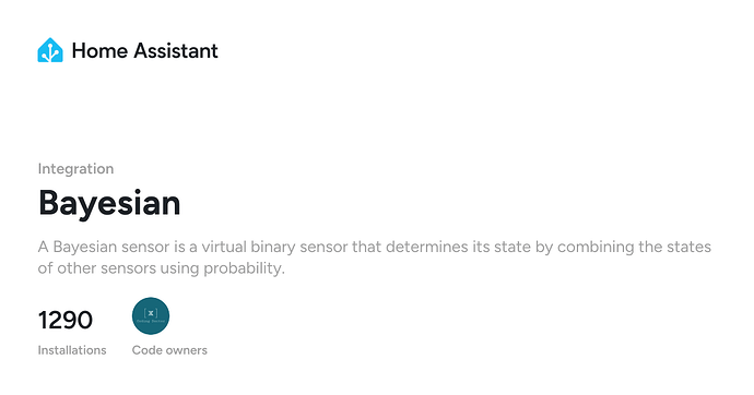

You could try a Bayesian approach.
This would involve looking at the sensor history and working out how often it’s triggered by the dog and how often by a person. The Bayesian sensor will give you the % probability that it’s a person and your lighting automations can act accordingly.
The advantage of this is that you can incorporate other observations as well. Time of day, for example - if you go to work, then during work hours it’s more likely to be the dog. Is the TV on (or whatever devices you have in the room)? If yes, then it’s more likely to be a person.

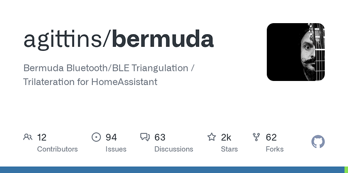

I do this to refine the output of the Bermuda room tracking integration. With enough observations it’s extremely reliable and ignores the dog entirely (although admittedly he doesn’t carry a phone).

Thanks for the detailed suggestion — the Bayesian approach looks like a solid way to reduce false positives without adding more hardware. I read the threshold Bayesian sensor docs and I’m curious about two things: First, does the Bayesian sensor still treat the mmWave as its main input, or are you feeding it multiple sources at once? Second, you mentioned the Bermuda room tracking integration uses BLE triangulation — does that mean everyone in the house needs to carry a phone or BLE tag? My dog obviously doesn’t carry one, but I’m also wondering what happens when a family member walks into the room without their phone.

My case is a very simple one as I live alone (with a dog), but you give it as many “observations” as you can - the more the better. This is an example of a “is anyone home” Baysean intended to account for the fact that I may sometimes leave my phone behind - the sensor turns on if all the observations together indicate a >90% chance that someone is in. (An attribute contains the actual percentage chance if you want to use that.)

Yes if you use the Bermuda integration on it’s own. I have tags on keys and wallet and a Bayesian sensor for each room which includes other observations. A template picks the room with the highest probability of occupancy. So with phone and watch in the kitchen on charge I still get
Which is correct. It would get pretty complicated in a large family. :laughing:
