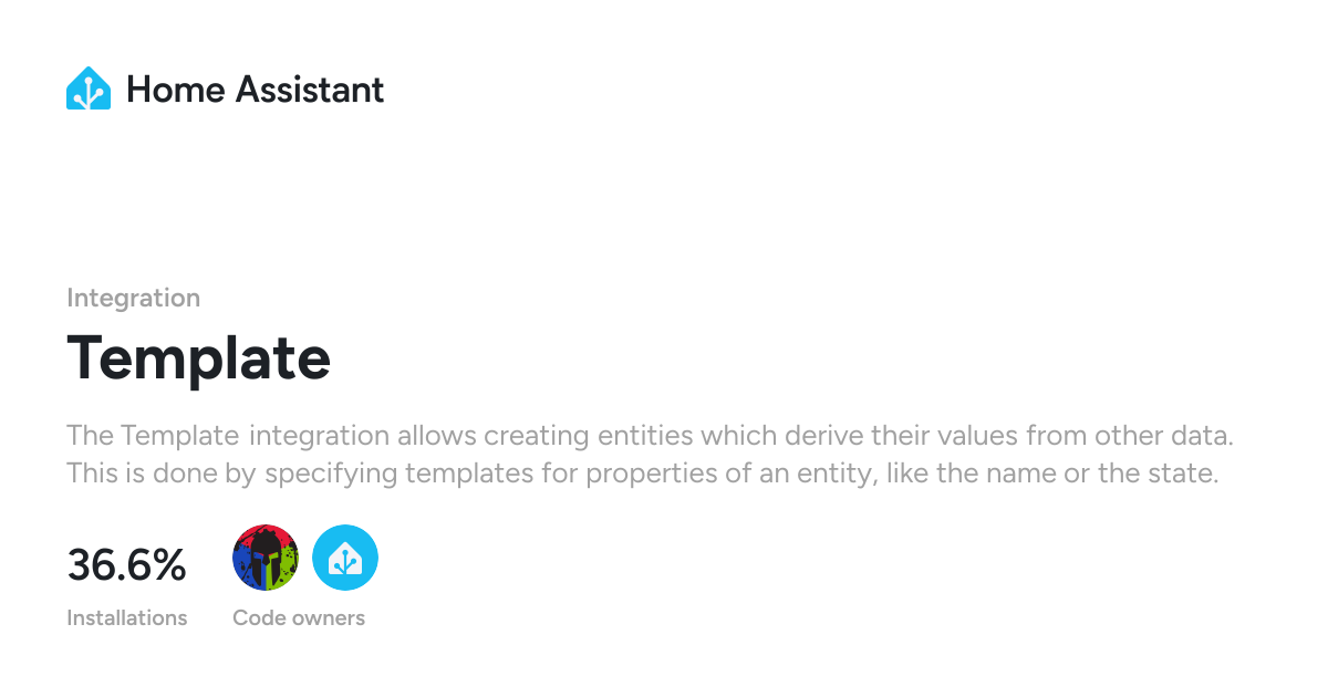

Is that actually working? The forecast state attribute was removed from most weather integrations like 3 years ago…
As to the icon, you just map the icons to the state value using the icon configuration variable:
Also, you are missing the temperature and humidity configuration variables, which are required.
