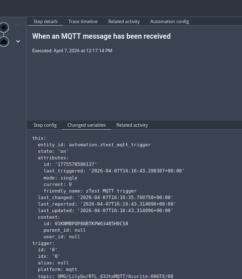

You will need to use a template that gets the value from the trigger variable. The precise template needed depends on the how the MQTT payload is structured. If you can share that, we can tell you what the template should be.
You can find the complete trigger variable object in the automation’s debug Trace, in the “Changed variables” tab near the bottom.

You’ll need to check the “Changed variables” tab toward the bottom of the automation Trace to see the actual structure of the payload being received, then we can help you figure out what changes need to be made.
Replace the Device Action with a number.set_value action. A Device Action does not support the use of templates.
