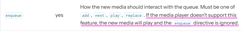

When I run the second play_media… it doesn’t play (with enqueue: next). If I try to just play it (enqueue: play)… it plays over the top of the previous one. I’ve put delays in between as well.
Anyone know the secret to playing audio files to media players in sequence?
https://www.home-assistant.io/integrations/media_player/#action-media_playerplay_media

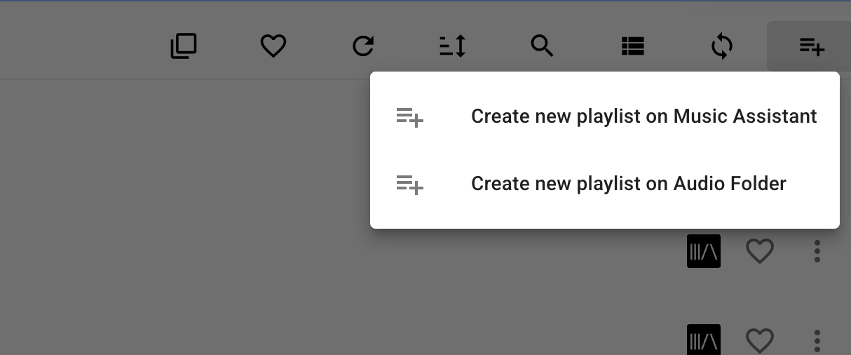

I see there are two options within music assistant:
I gather I try the audio folder because that is where the files are.
The problem I have found with creating a playlist in music assistant is there does not seem to be a way to play files in sequence, ie the order they should be played. There only seem to options to sort the items within the playlist by artist, album etc. Though there is a sort by position. Perhaps that relates to the order in which the files are added to the playlist.
I think this may be the go. Seems pretty obvious now you’ve mentioned it. One draw back is that there seems no way to re-order the tracks once they are in there. But for my purposes this looks very promising.
Thanks for taking the time to explain the ‘bleedin obvious’ to me :wink:. Been very useful.
