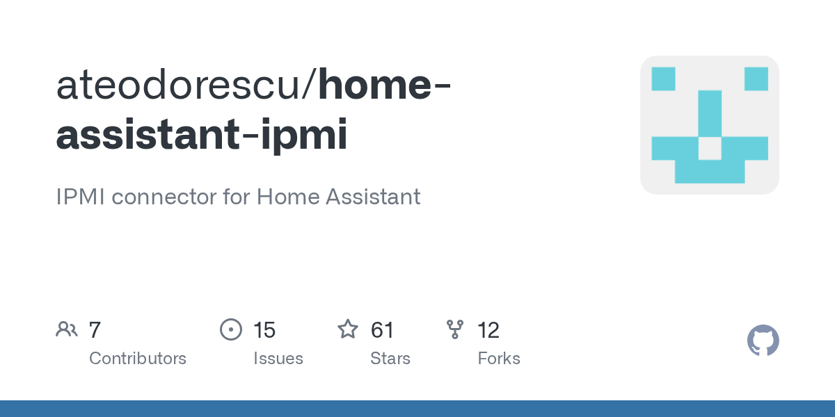

ps: i just discovered this tool:
bringing IPMI into HA via HACS!
