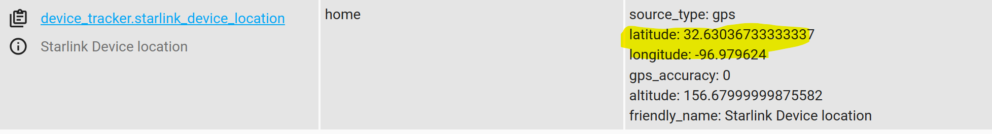

Unfortunately, somewhere in there I added the newer Starlink integration and lost GPS options. I looked in HACS but can’t find the old version.
Anyone using Starlink and still getting GPS data?
Found them - hidden under a device_location that just says I’m home.
I swear I did something like this long ago… is there a way to extract the attributes and display them?

Same or similar here; I swear I used to have entities for lat/long, w high precision. Now just attributes under Device Location entity, w only 2 decimal digits precision.

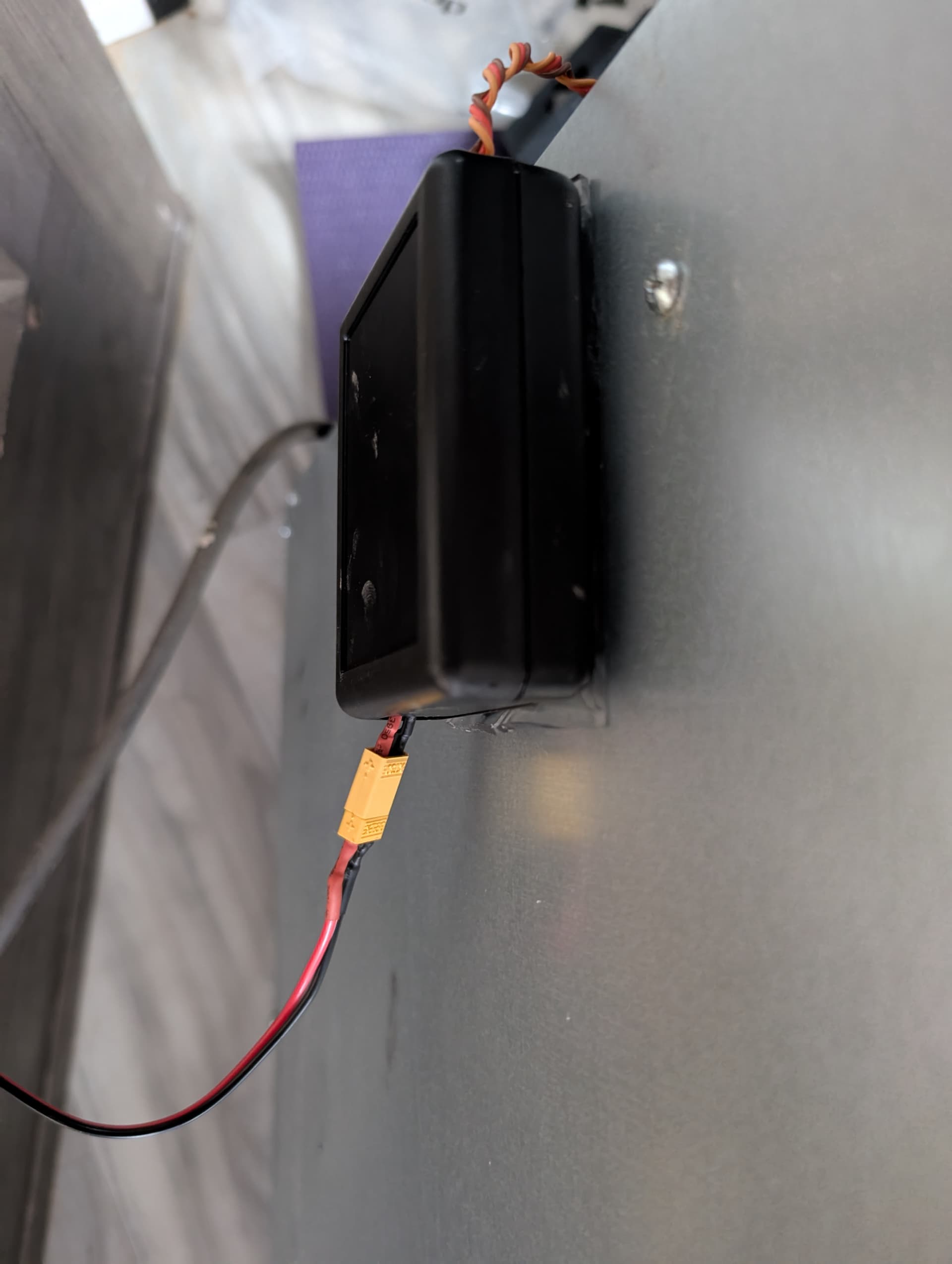

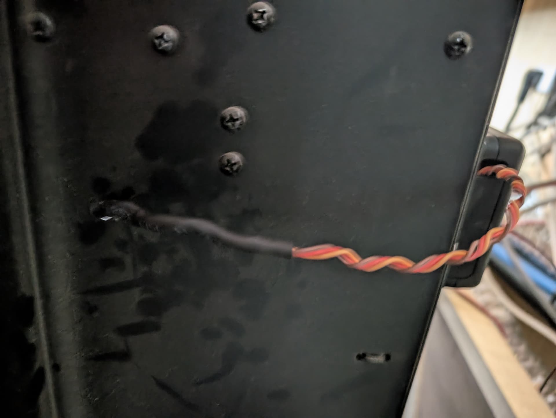

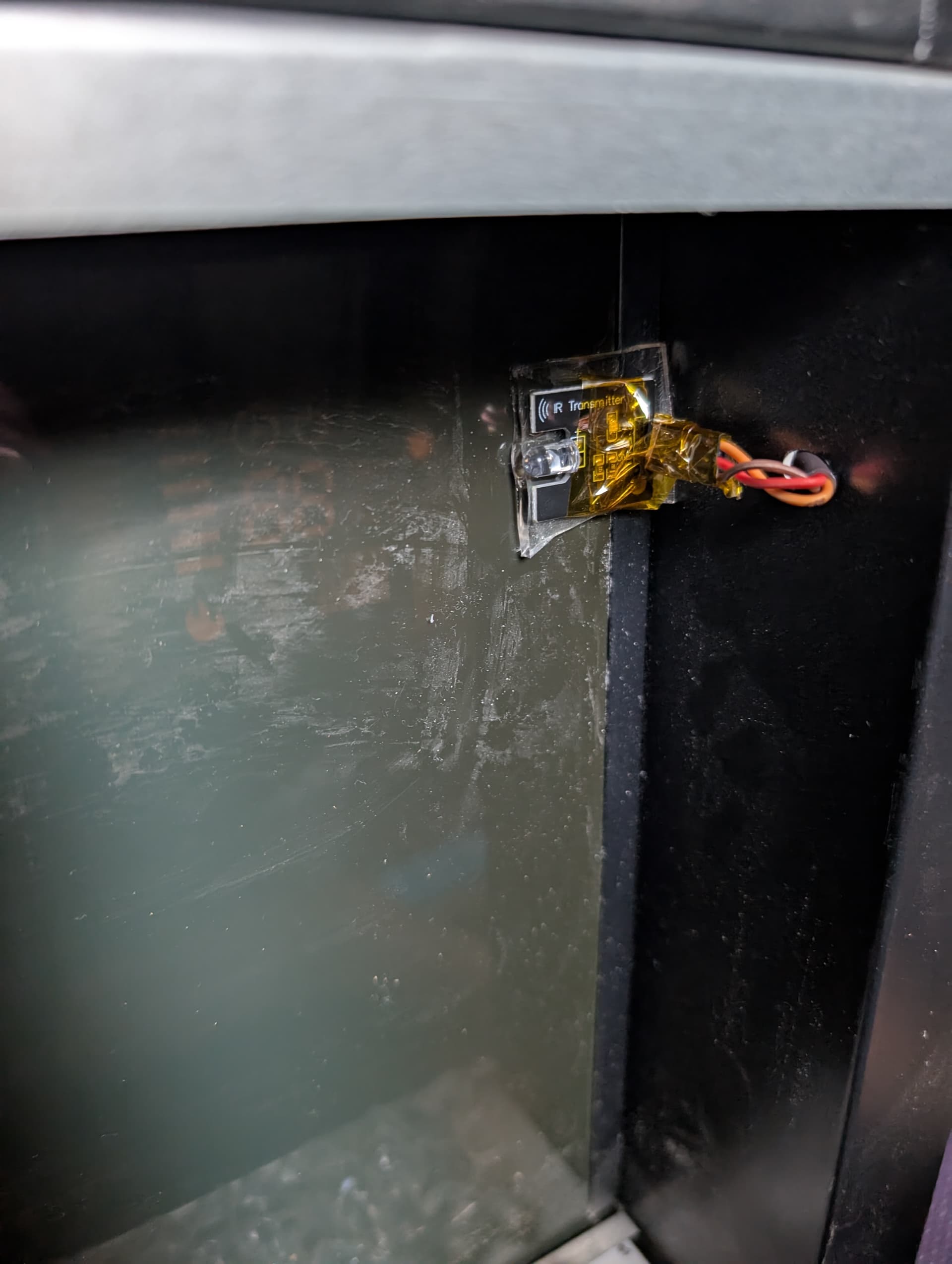

When my fireplace (glorified space heater) turns off at the outlet due to power shedding, it doesn’t turn back on once the outlet turns back on (it requires either a capacitive touch button to be touched or a remote control ON button to be pressed.)
I set up an ESP32 and an IR transmitter that sends the ON command when a virtual button is pressed.
I then set up an automation to detect the forced powering off of the outlet (either via my hardware shedding that turns the load from ~1000W to Unavailable or via my software shedding) and then presses the above virtual button once the power is restored.
I double-side taped the transmitter daughter board inside the fireplace housing so it’s mostly out of sight.
A little more background, for those interested: I used my Flipper Zero to read what command was being sent by the remote when the ON button is pressed, then used the Flipper again to confirm that I was sending the same command (so I didn’t have to bed sitting next to the fireplace the whole time.)
I tried using an ESP8266 at first because I didn’t need Bluetooth for this application. This was a bad idea, because everything was wired up exactly the same, but it just didn’t work. After much banging of my head against a wall, I noticed the ESPHome docs mentioned that they recommend an ESP32. I wired up a new board with one of those, and it worked first try :joy:. Don’t be like me. Read the docs before you heat up your iron.
