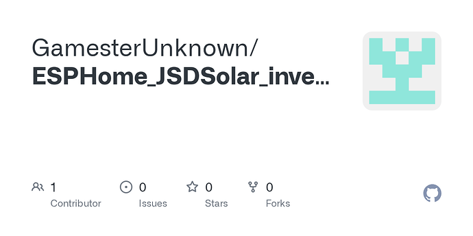

Try to use my ESPHome project

In the end, I didn't use the USB A port, but I disconnected the CN7901 connector and connected my ESP32 there,,, I paired it with my HA, and my converter in HA works for me
