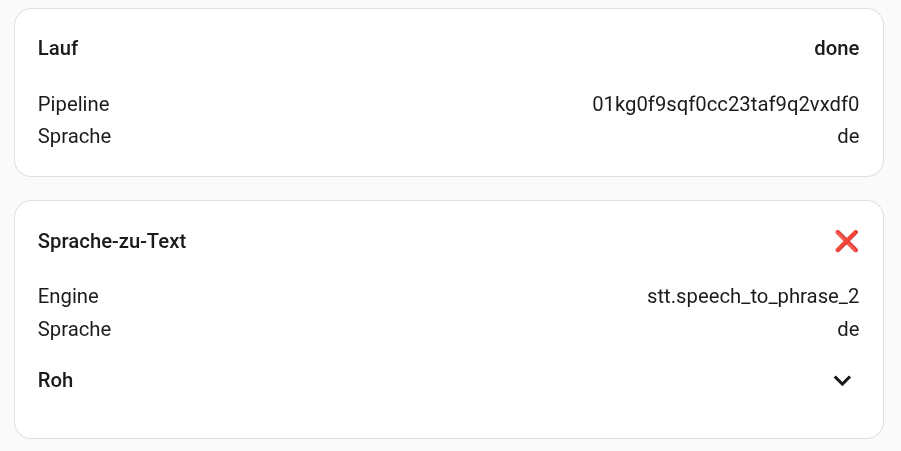

seams that speech to phrase is not adding any output to fire the corresponding automation.
