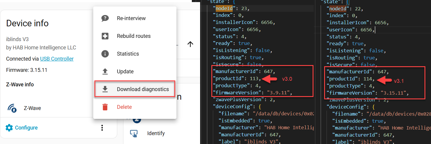

For the units that refuse to load 3.15, can you please download diagnostics for the node and check what is listed for Product ID? (there may be an easier way to see this)
  • 113 = iBlinds v3.0
  • 114 = iBlinds v3.1
This will confirm that the correct iblinds version. If you can post (or DM) the Product ID and firmware target shown in diagnostics, I can tell you exactly which GBL file is required.

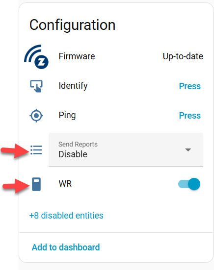

Make sure you have Send Reports disabled, and also turn on the “WR” (Window Reports) parameter.
Once Z-Wave JS updates the labels, this will show as Send Reports - Enable and Window Reports - Enable.

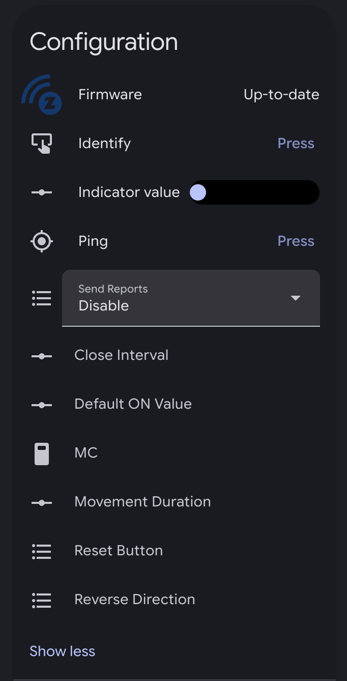

I don’t have a “WR” parameter in HA for my iblinds.
Try a HA core restart. HA doesn’t always pick up the changes in-flight.
