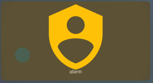

How is the visual "hold_action effect" generated?
I am referring to the bluish circle that appears after a moment at the point of the click or press when the card has a “hold” action defined. In the picture below, to the left of the icon.
I would like to recreate this effect using HTML, CSS, and JavaScript.
Edit: I found it, it’s defined in action-handler-directive.ts, and here are the properties I was looking for:
