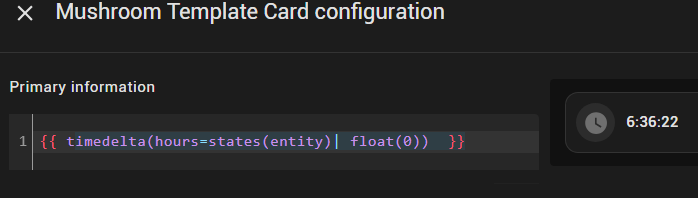

Although I setup my sensor, when I’m trying to display that with Lovelace
  - entity: sensor.feeder_on_today
It’s display that as hh:mm eg (0h 3m)
I’ve spent a couple hours trying to find a way to display h:m:s and keep going in a circular google loop. Is there a way to use templating or something else to display this duration to include seconds?
It will retain the hourly statistics for that sensor indefinitely. You will want to customize the sensor so that it has state_class: total_increasing so that the statistics are useful. Then, you can use a statistics graph card on your dashboard to show the daily “on” time of the relay (or weekly, or hourly, or whatever interests you). The “note” on the history_stats docs page mentions this.
You will need to choose a card that supports templates. There may be other card options but I know very little about dashboards and someone else will hopefully chime in.
Hi, using a mushroom template card:
{{ timedelta(hours=states(entity)| float(0))  }}
(note - you can show the seconds, but a history stats does not update every second)
