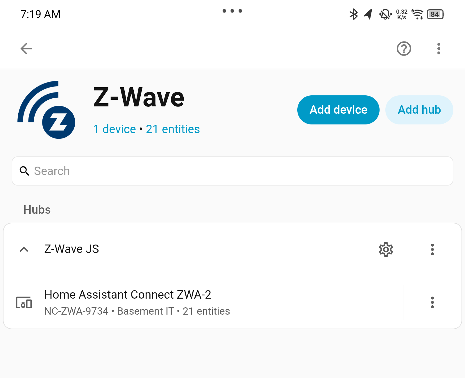

  1. I've followed the docs and I think I've installed the ZWave integration, LONG delay notwithstanding. See pic below.
  2. I know I don't add a device using the August app alone, but the app is required. Unlike most devices where you press and hold a button, there are no buttons on the August device. You use the app to put the device into "joining" mode. (The app communicates with the device via Bluetooth.)
The August docs are clear enough. In HA, go to Devices, ZWave and click Add Device. Then go to the August app and click Join to Network.
