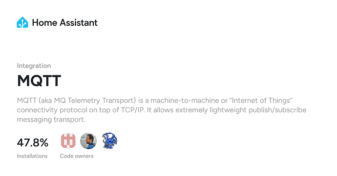

There are many ways to integrate with HA.
It can be websockets, restful, MQTT, your own integration or a bunch of other ways.
MQTT is a common way, because it is not a standard that is tied to HA, so other apps could use it too.
HA have a standard for MQTT that allow automatic creation of devices if you like, but it is still just MQTT.
