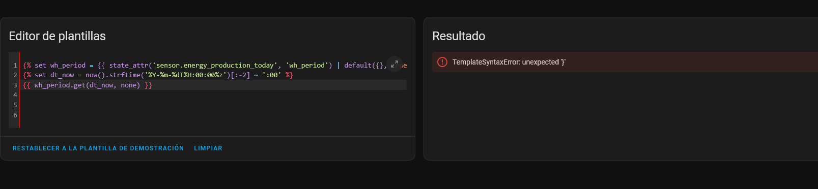

pepe2
(Pepe)
July 4, 2025, 6:58pm
4
Sorry, I looked in the wrong table (not the wh_period ). It has to be in the watts table.
I tried the template of WarLion. It is working but the time now it is 20:56 in Belgium and the result gifs the value 724. That is the value at 20.00.
{% set wh_period = state_attr('sensor.energia_hidro_energy_today', 'wh_period') | default({}, true) %}
{% set dt_now = now().strftime('%Y-%m-%dT%H:00:00%z')[:-2] ~ ':00' %}
{{ wh_period.get(dt_now, none) }}
You should not wrap a state_attr() function call in {{ }}
123

Why should I do that when I am assigning its result to a Jinja2 variable?
{{ … }} is used for output
{% … %} is used for logic
You’re essentially trying to output something {{ … }} inside a logic block {% … %}, which doesn’t make sense and will result in a template syntax error.
123

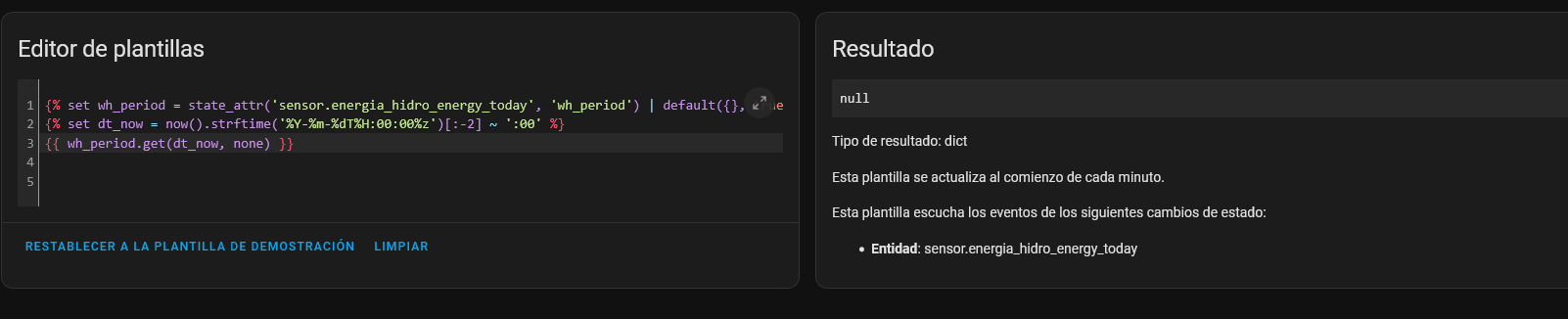

123
(Taras)
July 4, 2025, 7:06pm
11
I am assigning the output of state_attr() to a Jinja2 variable. Please post an example of another way to assign a value to a variable.
Duh! I now see what you’re saying!
It’s a copy-paste error I made when I transferred my test example to the forum.
Thanks for pointing it out to me!
i did in this response to your code
