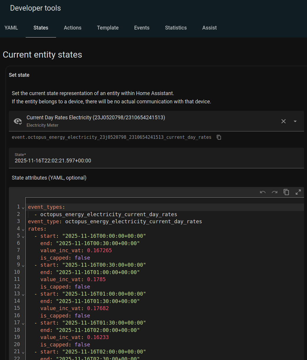

I want to be able to publish, using MQTT the information that I can see homeassistant holds when I look in Developers Tools → States (see below) The info is being collected by an Octopus integration, and used within different integrations. I am already happily sending and receiving other info such as immersion temperature and battery SOC but I just don’t seem to be able to access this info from within an automation. (The best I can do just sends “{“platform”:null}”)

PS after re-reading your first reference I am slightly more confused about what exactly constitutes state and state object Does state used alone refer to the attribute of the object called state? In the screen-shot in my OP, is rates: an attribute of the state or the state object?

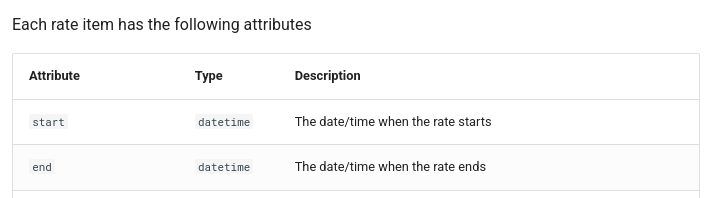

Based on that error and the integration’s doc
An issue is that the start and end values of each item in the rate list are datetime objects. Datetime objects are not JSON serializable, so you need to convert them to datetime strings before using to_json.
Well, if you understand that trigger.to_state represents the complete new state object of the entity and that you can access that same data with states.event.octopus_energy_electricity_23j0520798_2310654241513_current_day_rates (as described in the “Building Templates” page linked above), you can refine your templates in the Developer tools → Templates tool. The following will allow you to tinker and test your template without having to worry about the automation part:
{% set trigger = {'to_state': states.event.octopus_energy_electricity_23j0520798_2310654241513_current_day_rates} %}
{{ trigger.to_state.attributes.rates }}
There might be a way to do this without an explicit loop, but this is what came to mind:
{# The following is what would be used for payload in your mqtt action #}
{% set ns = namespace(r_list=[]) %}
{% for r in trigger.to_state.attributes.rates %}
  {% set start = (r.start).isoformat() %}
  {% set end = (r.end).isoformat() %}
  {% set ns.r_list = ns.r_list + [{'start': start,'end': end,'rate': r.rate}] %}
{% endfor %}
{{ ns.r_list |to_json }}
The state object is a collection of properties of an entity. Both state and attributes are properties of the state object as well as others like last_changed, name, etc.
  • state is a string, usually representing the most important data point for that entity.
  • attributes is a dictionary containing it’s own collection of data… one of which is rates in this case. Most of us will just describe rates as an “attribute”.
