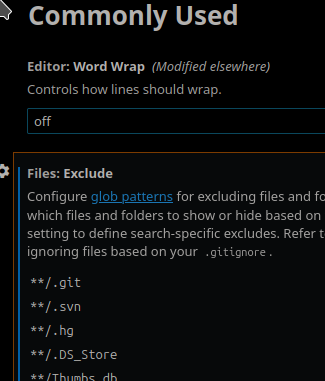

in studio code go to settings and search ‘show hidden’ or ‘files exclude’
can’t remember 100% but I’ve managed to get my .storage showing if I remember correctly
Hello Jan,
Pretty simple really.
VSCode Server, hit the gear and under user and workspace tabs, find files: exclude.
It’s probably found right there in the Commonly Used section it opens to. But it might just show up there for me because I have set mine.

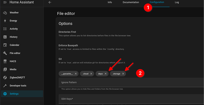

For the File Editor add-on, go to the Configuration, and you’ll see that some folders have been preselected in the exclude section.
Just remove the ones you want to access by clicking on the cross next to the name of the folder.
WARNING: These have been excluded by default for a reason, so please be careful when editing anything inside these folders.
