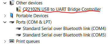

I read that you need to connect a USB cable from your PC to the Yellow. When I do that I don’t get COM a port created as described in the docs but rather a “USB to UART” device like this:
I read other documentation which describes using rpiboot. Will rpiboot allow me to access the Yellow console via the bridge controller device created?

I’ve confirmed that this procedure of using a USB drive with a CONFIG folder wtih the SSH keys does NOT work on the HA Yellow. You need to connect a USB cable to the Yellow then use Putty to connect to the serial port.
