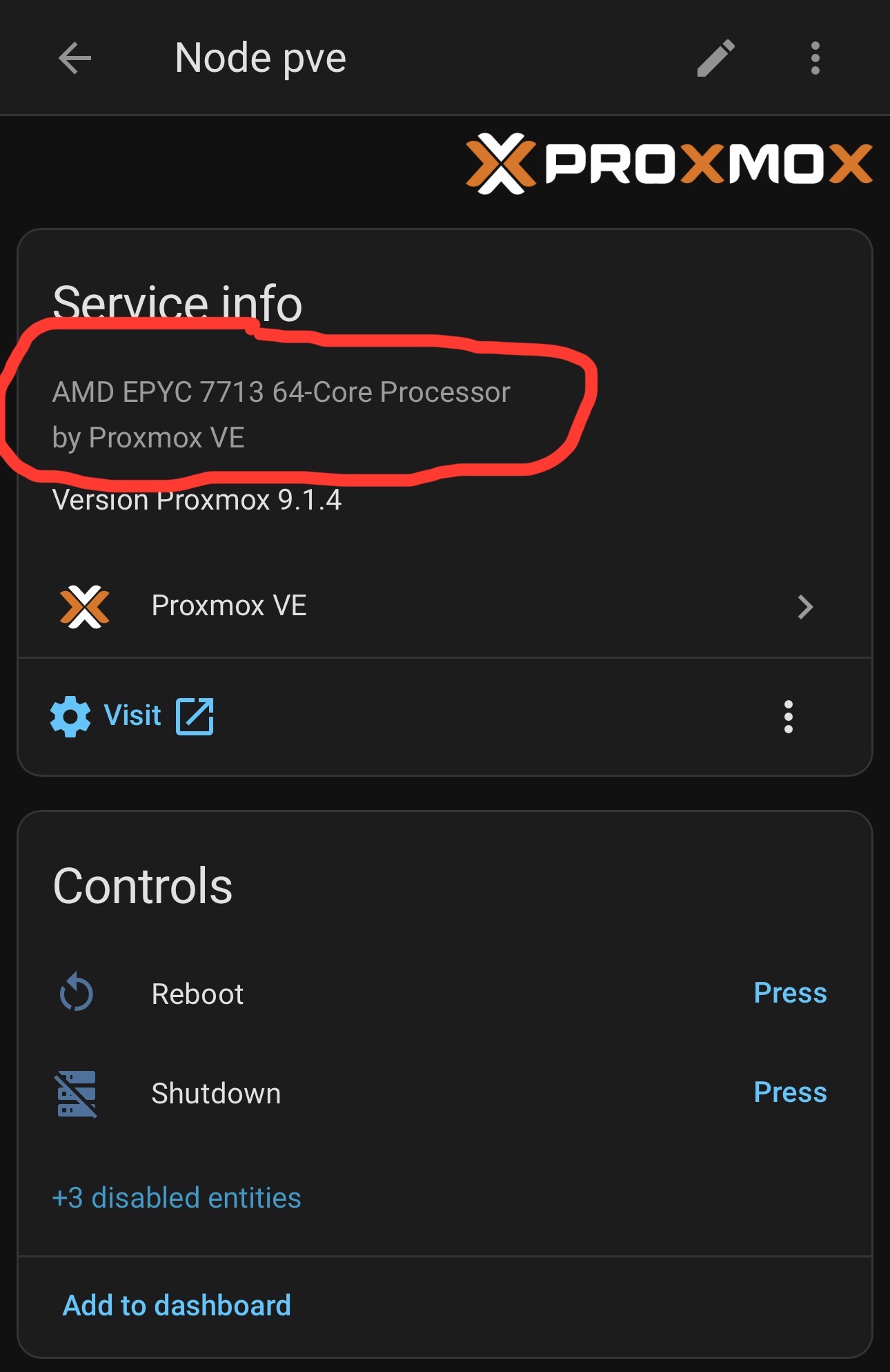

In the Devices menue, I can select a device, and it displays kind of a sub-headline (s. image).
How can I access this information for the frontend?
That is the model and manufacturer. Templates can extract it via
{{ device_attr('2ce54...', 'manufacturer') }}
{{ device_attr('2ce54...', 'model') }}
(or try model_id instead of model)
Replace first argument with your device_id
Thanks, worked (after I figured out how to get the device_id).
