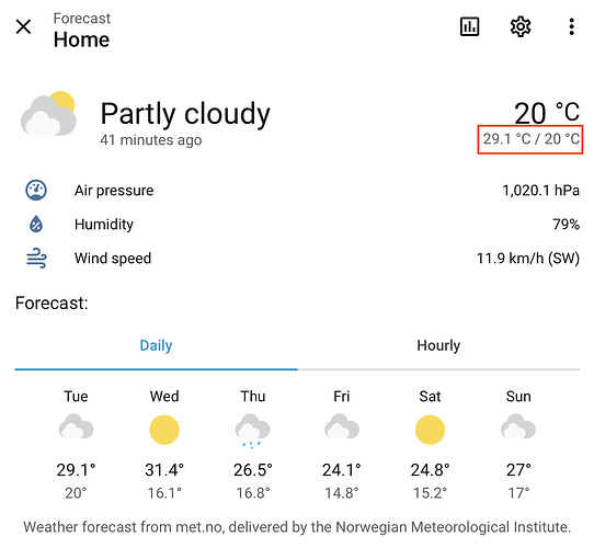

I use the Met.no weather integration which I display in the normal card:

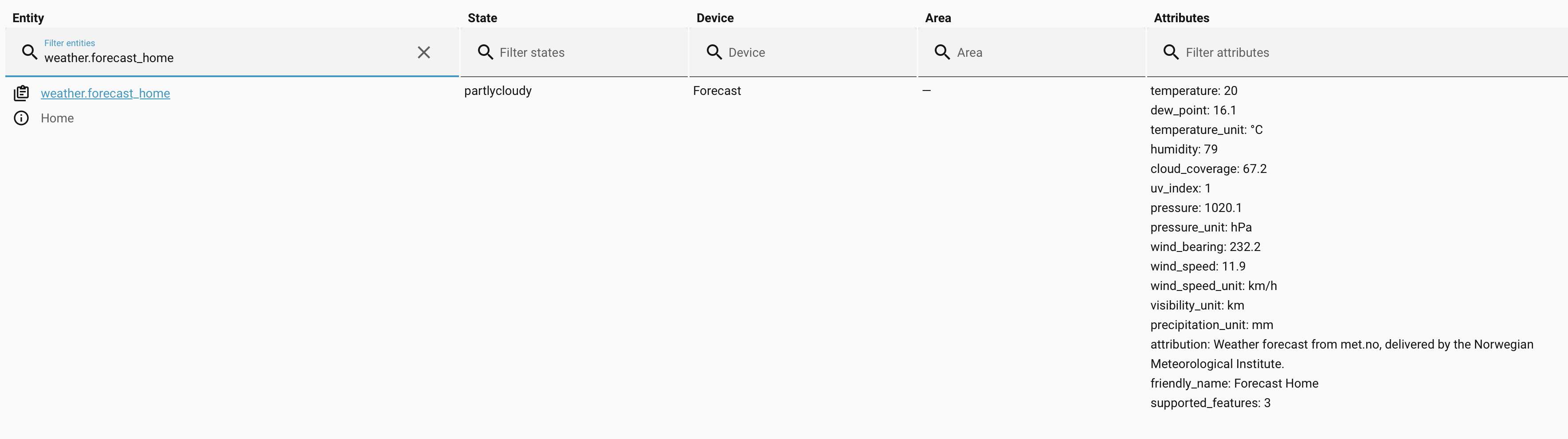

As well as the current temperature, this card displays today’s forecast max and min temperatures (highlighted in the screenshot). I want to access those in a helper but they do not seem to be attributes of the entity:
What is the easiest way to access those values?
