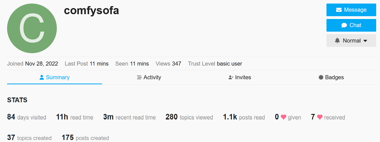

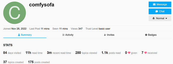

These are your stats:
Member/using HA since 2022.
37 topics created: none of them are marked as solved! :thinking:
175 posts created.
0 appreciation towards people that help you
With these numbers I would advice you to dig a little deeper yourself if you want to get the max out of HA.

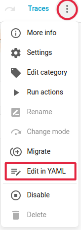

Post your automation’s YAML code.
To get your automation’s YAML code, display the automation in the Automation Editor then switch the display mode from Visual to YAML mode.
Copy-paste the displayed YAML code into your forum message. Select the code and then click the forum editor’s “Preformatted text” command. It will ensure your automation’s YAML code is properly formatted for display in the forum.

You can switch to YAML mode and copy the YAML code without having to first save the automation.

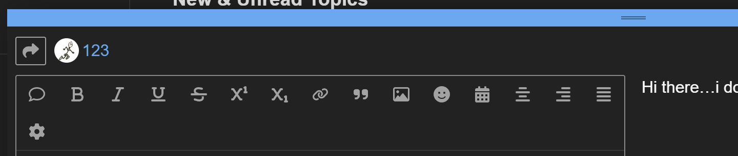

Hi there…i dont have that option from what i can see…

Interesting. Click the gear icon. It may be in there. If not then put three backticks ``` on a separate line before your YAML code and then do exactly the same thing after your YAML code.
More details here: How to format your code in forum posts

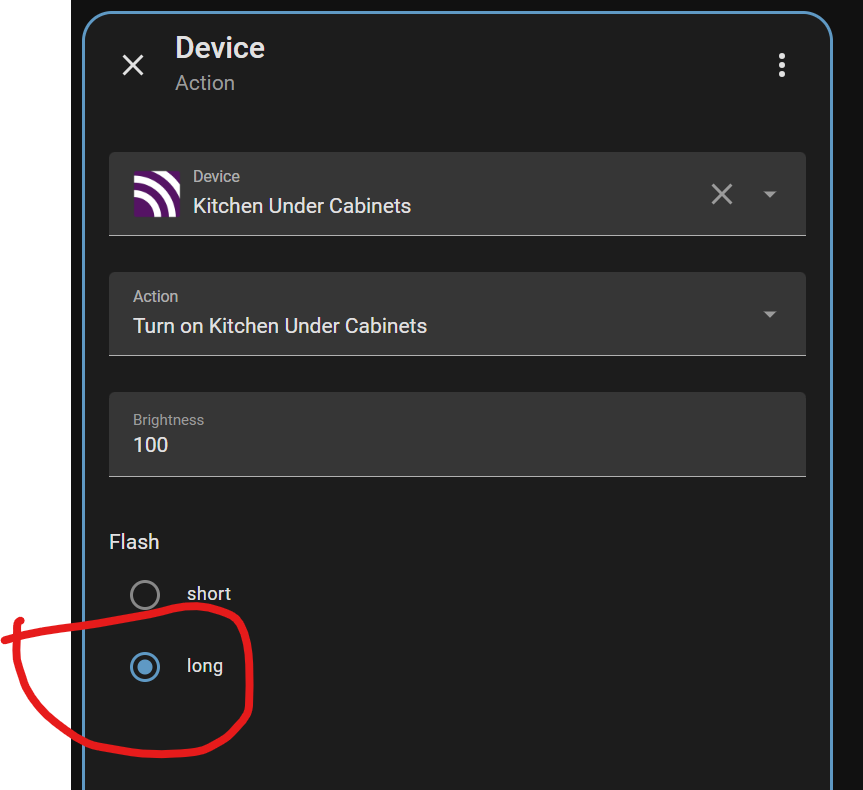

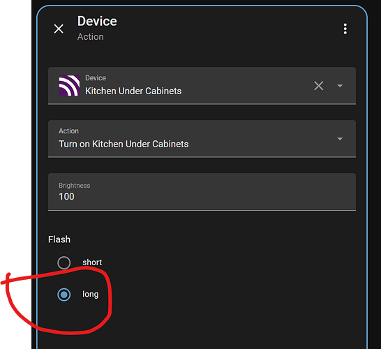

Well, this has take a strange turn…ive just created it again and its saved ( i have no idea why? or how for that matter )…within the options theres a couple of values i dont understand though…this one?
Ive just set it as that but no clue what it does…
