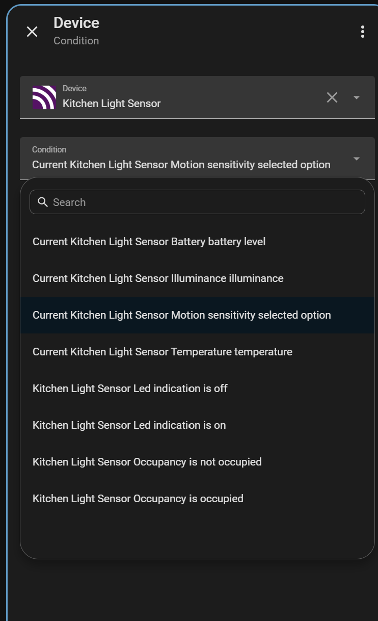

What is the purpose of this select entity you included?

I really dont know…! i selected medium as i had to select something otherwise i wouldnt be able to save it…
All i want is the motion sensor to swtich the lights on when activated…when its dark…
These are the only options that are available to me…all i want is the sensor to switch the lights on…
Then you’re in good company because we also don’t know why you did that.
As far as I can tell, that select entity isn’t needed to fulfill your original requirements:

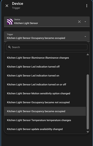

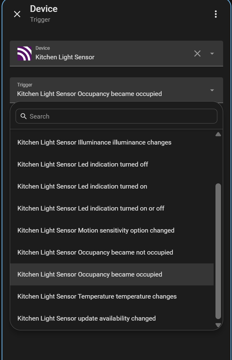

Well its a learning curve!..so ive got these the wrong way round then…?
So if i put the motion sensor at the top…which of the values are the toggle? (or the option to switch on?)
Yes.
You need it to trigger when motion is detected then check if it’s after sunset.
The one that’s highlighted (Kitchen Light Sensor Occupancy became occupied).
