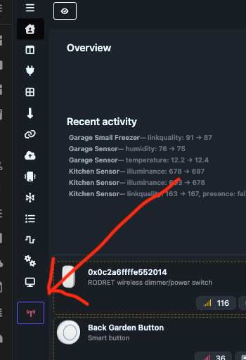

I have seen references to “Permit new device”, but no idea where this setting is at. I was able to add devices to Zigbee, but cannot add anything to Zibee2MQTT, and nothing ever shows up.
Sorry, I have no idea what that is.

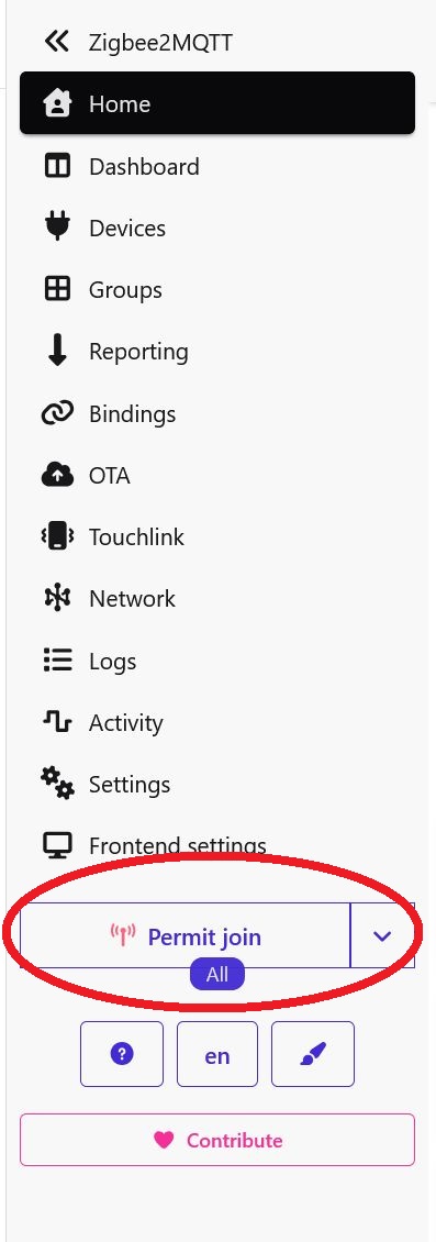

The “permit join” button
I guess I do not have one.
HA → Settings → Apps → Zigbee2MQTT → Open web UI → Permit join

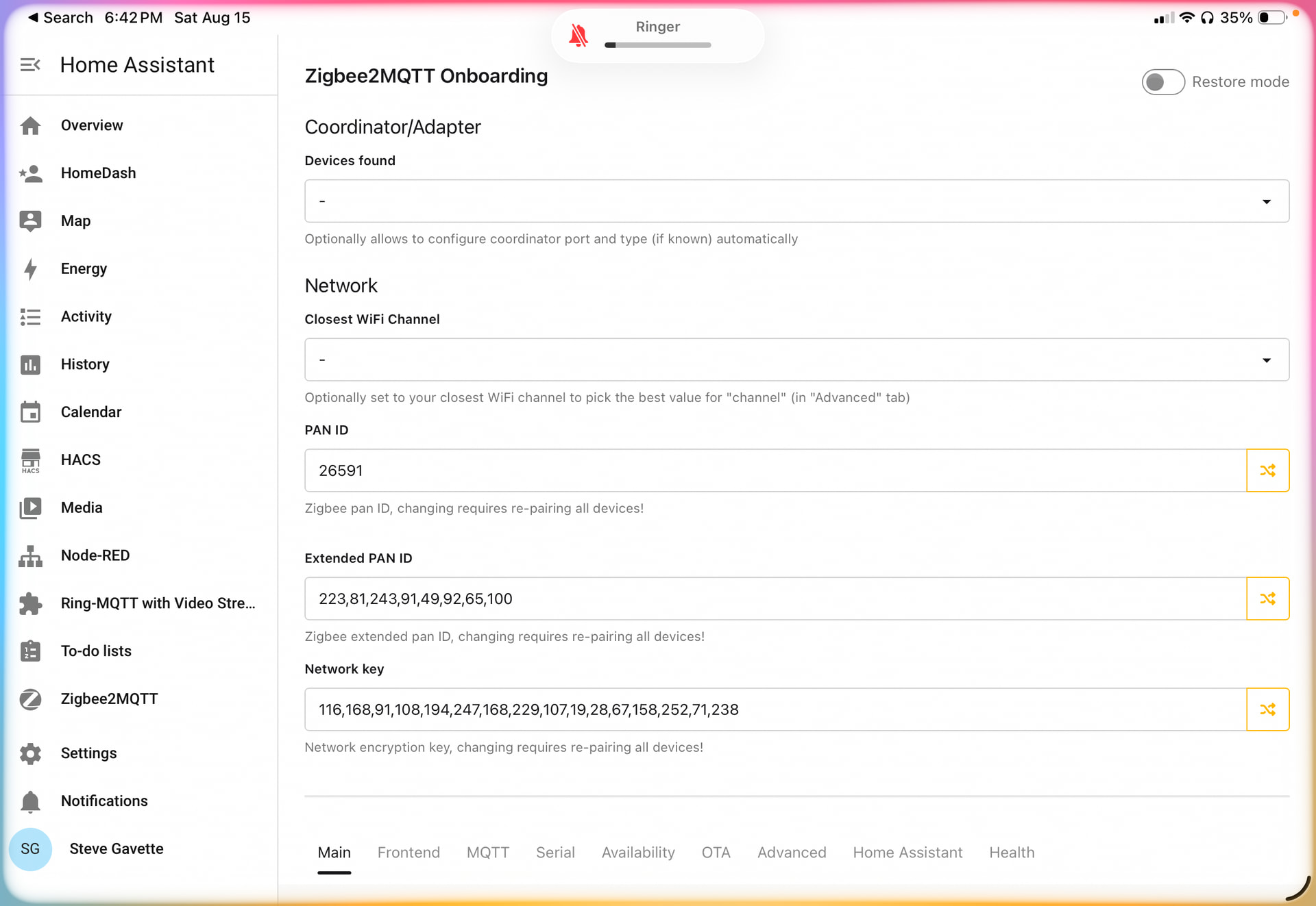

I thought I did, i select onboarding but it goes back to this screen with no errors.
It looks like it hasn’t found your coordinator - if you know the port it is on you can configure it manually. Stop Z2M and then use the configuration tab on the app in Settings | Apps | Zigbee2MQTT.
