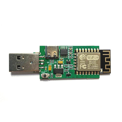

The link you provide says dongle uses midea esphome component
Esphome file are fairly generic and kinda just work
Look at dongle and identify the Esp Chip type. Esp32, esp8266 or other. Post picture here or numbers/letters and someone can help
After identify chip you just need “+ newdevice” >> continue >> add name >> select the esp chip type >> “skip” install
