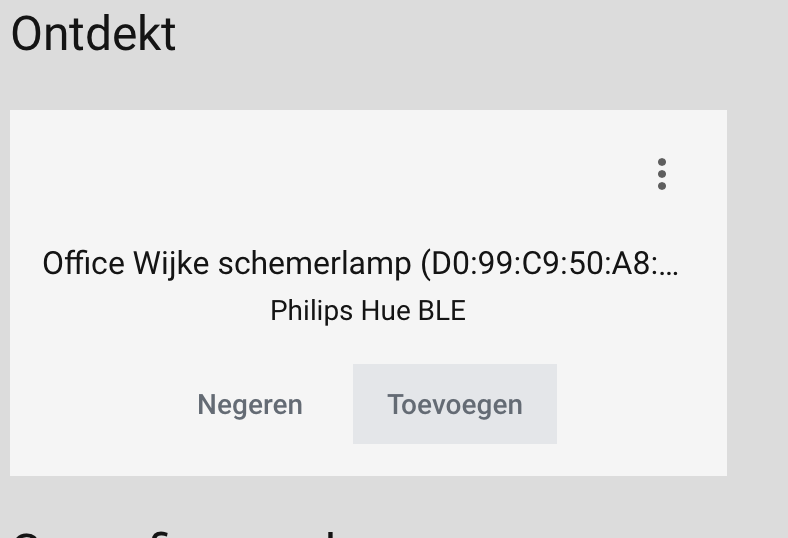

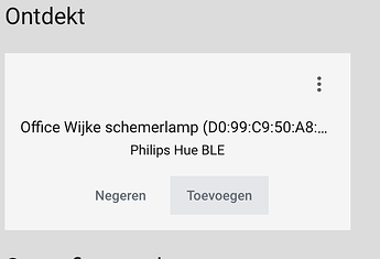

So, even though I get discovered lights in the integration panel, it is completely unclear to me how I can include them.

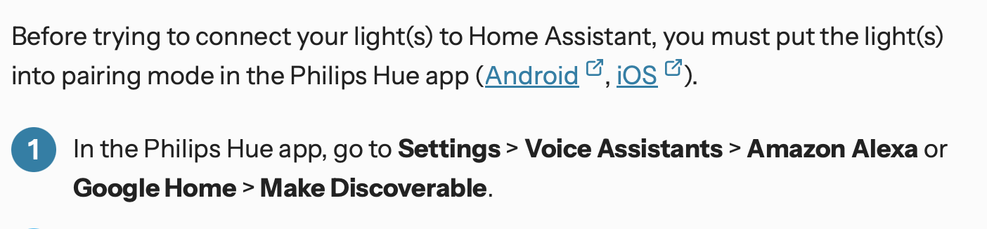

The instructions in the documentation are not correct,
at least with the current Hue app. There simply is no such thing as a ‘voice-assistants’ setting an hence ‘putting them in pairing mode’, is not available either.
All we have is ‘Smart home’ and when clicking the + there we are redirected to go to the Google Home app, which is definitely no what I want.

yeah, but my ask here is: how to integrate those BT discoveries.
we cant follow instructions, because they are incorrect. At least not conform the Hue iOS app

Yeah could be. Otoh, several lights that are already on the hue bridge are discovered as BT now by the new integration.
So, still sending BT apparently

how to get the lights into BT discovery mode via the mentioned Hue app. thats all I need to know.
Dev said I dont need the Google Home app, but other than that, there are no options in the App.
And ‘Voice Assistants’ are not in the App settings. so docs are not correct

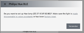

Factory new lights are ok, as I mentioned earlier,

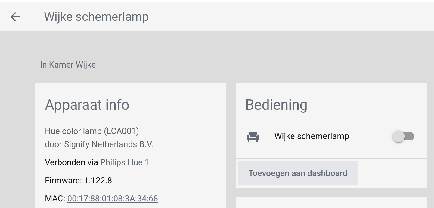

But that is not what this was about. the discoveries in Ha are from already Bridge connected lights (and already set up via the regular integration), but now for their BT connection
see:
while already being connected via the App/Integration
the difference in naming is because of the App, and address is also different, because different connection (at least that would be my best guess)
Well the directions clearly say “once the light is in paring mode”. So that’s likely what needs to happen for it to work.
Yes, step 1 is misleading. You can always adjust the documentation to remove that.
