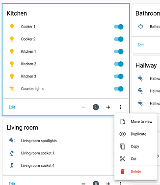

I’m trying to create (or copy) the card below containing numerous lights. The card with multiple lights was created by HA and lives in the "Devices “Hopefully” dashboard. But when I create a card I don’t see how to add more than one light to it. Or copy the existing one.

That looks like an entities card.
Ah! Thanks I’ll check it out.
Thanks I found the entity option when adding a card.
BTW- The easiest way to copy a card is to copy the YAML code then add a “Manual” card, edit in YAML and paste the code. You will have to change to your entities.
That’s good to know thank you! I was wondering how to copy an existing card.

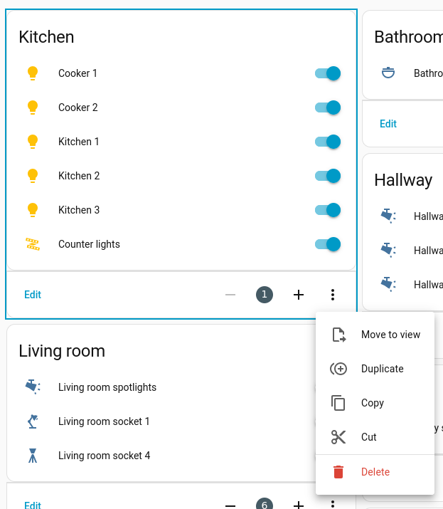

There are “duplicate” and “copy” options in the overflow menu (bottom right).
“Duplicate” will create a copy of the card on the same dashboard, and you can then move it using the “move to view” option.
