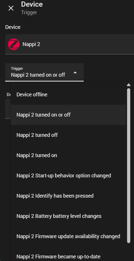

The single click event shows up in the event for the device
But the toggle is not an option when trying to use it:

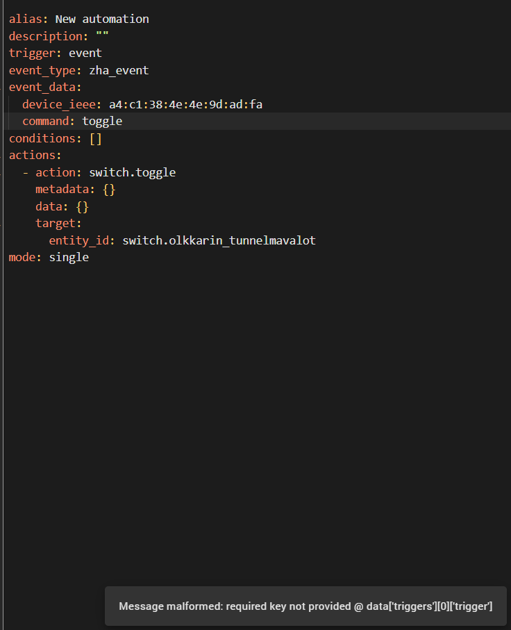

Is there something wrong in my code?
In the future, please follow Community Questions Guideline #14.
The config is missing the triggers key and the event trigger is improperly indented:

Thanks! I’m new to yaml, so it’s not really easy to troubleshoot these myself.
Now it works like it should.

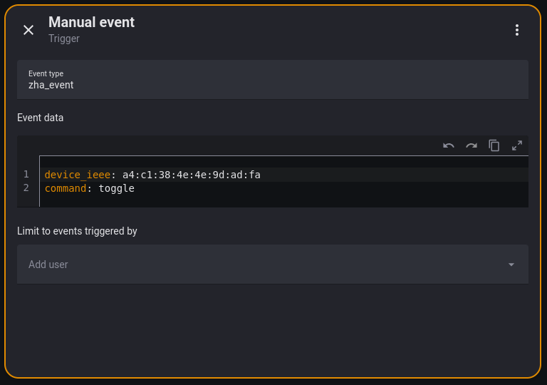

Just FYI, you can set up Event triggers in the Automation Editor if you want to reduce the amount of messing with YAML. For your event it would look like:
