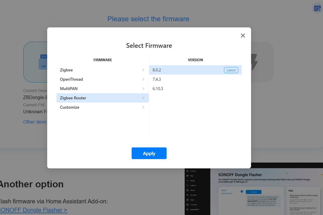

I have already flashed the ZBDongle-E with router firmware using the official Sonoff web flasher:

I flashed the ZBDongle-E using the official Sonoff web flasher (https://dongle.sonoff.tech/sonoff-dongle-flasher/) and tested the following Zigbee Router firmware versions:
• Zigbee Router – 8.0.2
• Zigbee Router – 7.4.3
• Zigbee Router – 6.10.3
After flashing each Zigbee Router firmware, I reset the dongle and attempted to join it to my existing Zigbee network in ZHA, but the ZBT-2 coordinator never finds the device.
