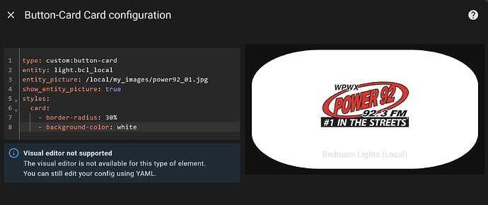

The first way would be to use a custom:button-card instead. Just upload the picture you want to use to HA and then style the card the way you want it. I created a folder for my images called “my_images” in the “config” directory.
type: custom:button-card
entity: light.bcl_local
entity_picture: /local/my_images/power92_01.jpg
show_entity_picture: true
styles:
  card:
    - border-radius: 30%
    - background-color: white
