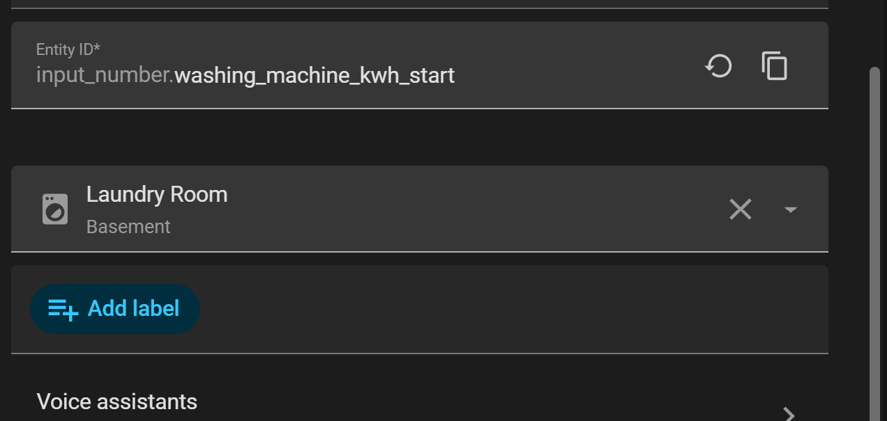

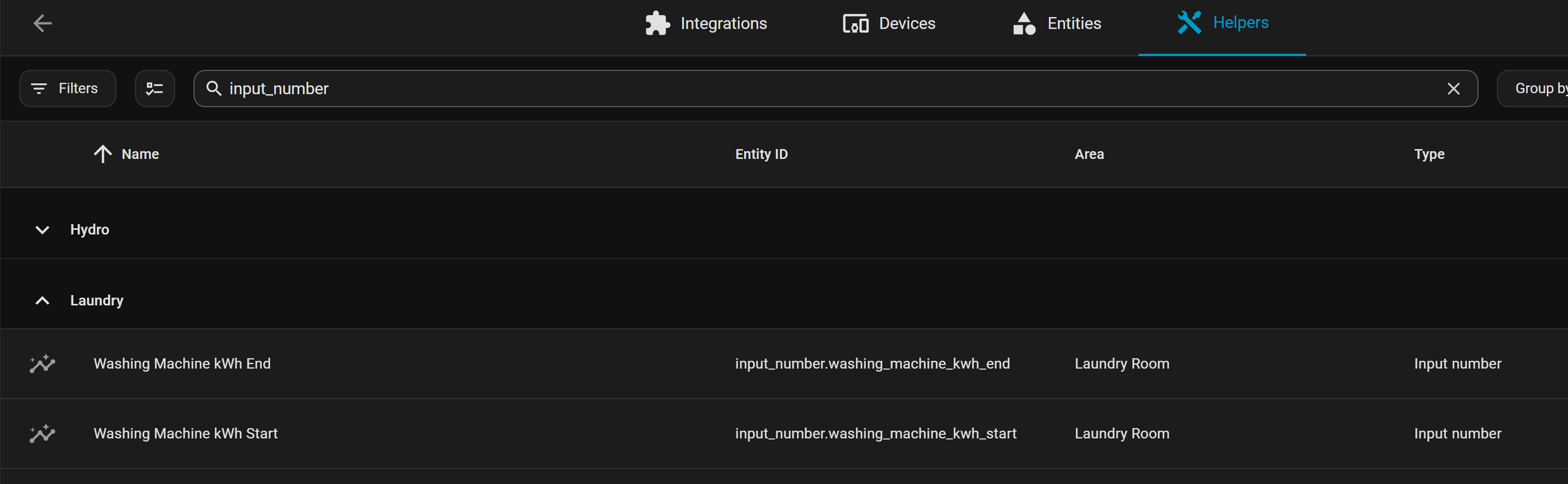

Err… not so much. I have 2 created in YAML within Packages and have assigned an area to them.
input_number:
  washing_machine_kwh_start:
    name: Washing Machine kWh Start
    icon: mdi:chart-timeline-variant-shimmer
    min: 0.001
    max: 10000000
This must be somewhat new, not sure how that’s done without an entity registry

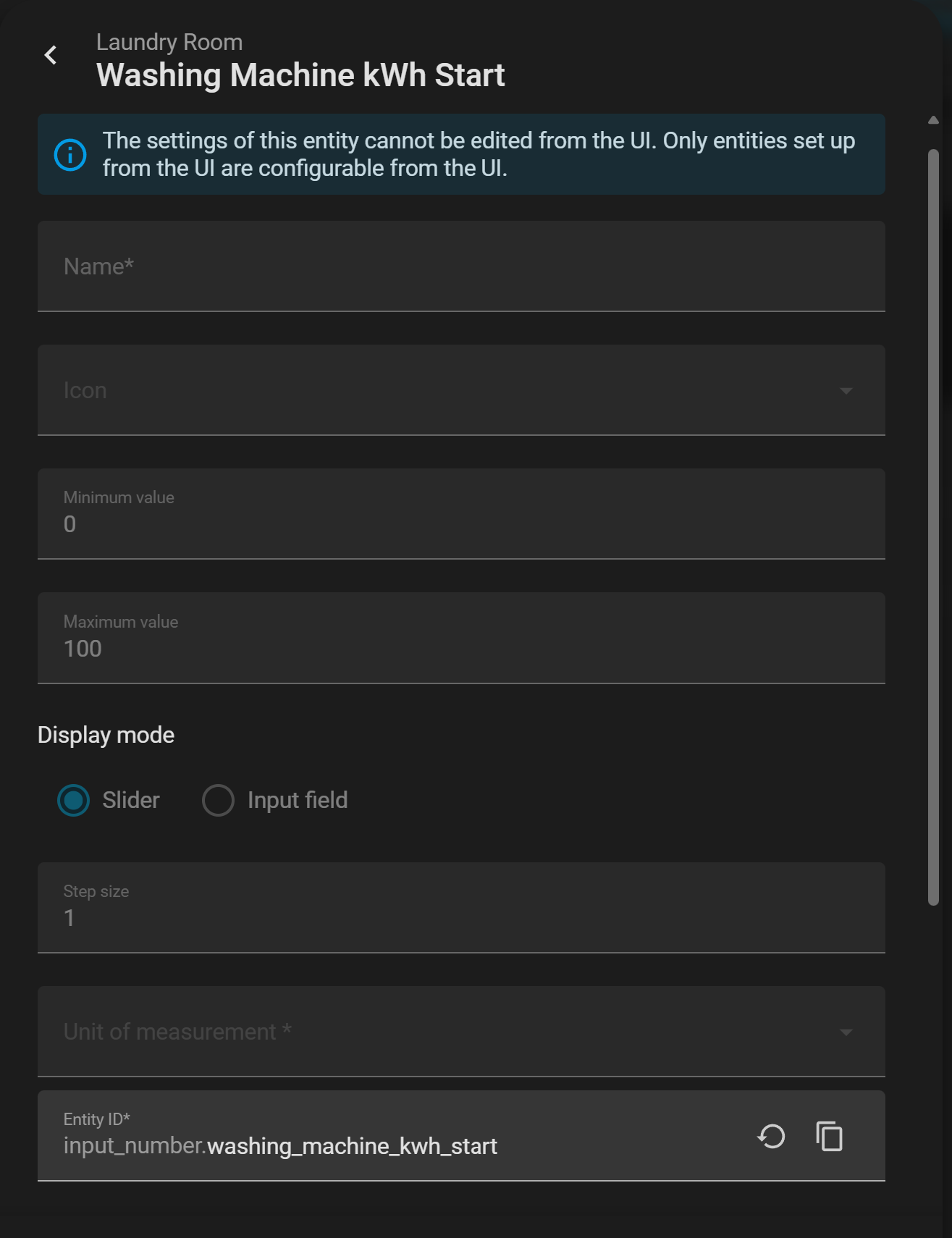

@ACKAPOB It works on HAOS 2026.7.1, I’ve only recently started making sure my set up is appropriately tagged with areas on everything and labels where appropriate so I have no idea when this would have started to work. I notice you’re running OS 2026.5.3 still.
Yes, the unique_id is what gives HA the entity registry which allows the eidting from the UI. But you’ll notice on your yaml helper that editing from the UI is locked.
