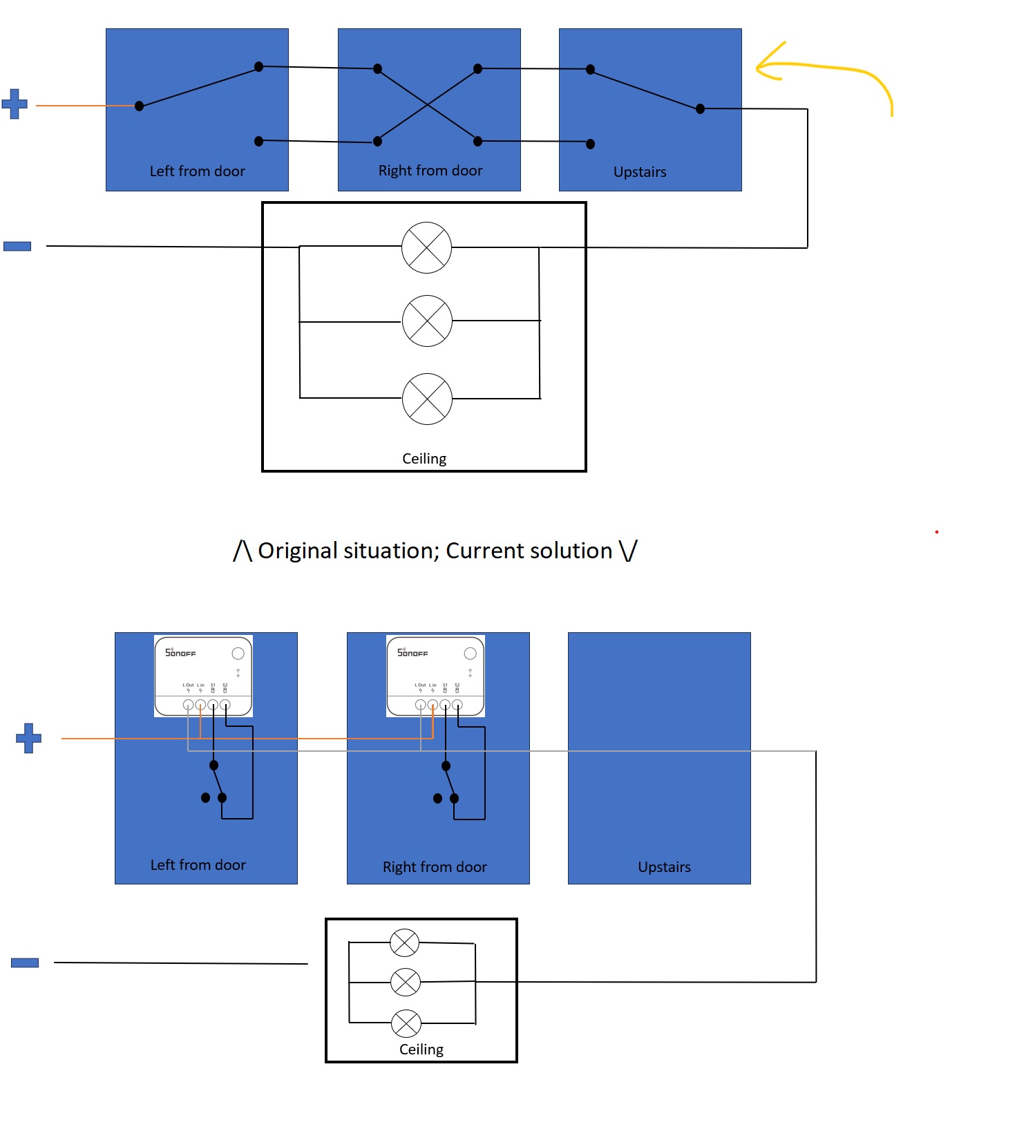

I am in the Netherlands and I want to automate the lights in my hallway. There are 3 lights in the ceiling. They can be controlled by 3 switches. 1 upstairs, 1 downstairs when coming down and 1 when entering the hall. See the picture for the wiring diagram of the original situation.
I have no neutral running passed the switches. I want to avoid puling a cable, since I am not sure how they run, because the cables in all wall boxes enter from the same side. I cannot find the split in the ceiling and I want to avoid breaking it open. (I remain searching for it, I will update when I have found it)
I currently have installed 2 Sonoff ZBmini L2 modules and made an automation in HA such that the lights turn on and off based on the status of the 2 Sonoff devices (see the picture for the wiring diagram of the current solution).It works, but not smoothly yet. Also, I have to install 1 more Sonoff module, so that the upstairs switch can also be used. Before doing that I wanted to do some more research. Therefore I am posting here.

For the upstairs switch, is there another switch or outlet next to it? so you still use the live wire for the relay instead of pulling new one

Yes there is. It is part of the lights circuit on the second floor. It has a similar situation which I also want to make smart. I will check if there is a live.
Otherwise I might have another solution like @ferbulous you suggested in another topic. you mentioned the video about the magic switch. Also based on a Sonoff module. I am still testing this.
I will give an update when I have tested either of the solutions.
